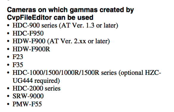

Thanks for the response. The reason i am trying to upgrade my F900 is i would like to use the CVPeditor software to load custom gamma curves in. The software I have in the 900 is too old to allow user gammas.
IF: V1.41
SV: V1.06
SY: V1.18
Also, do you have any scene file settings i could load into the 900 via the memory stick? Thanks.

How do I upgrade the "AT Version". What even is that?

Here is a photo listing

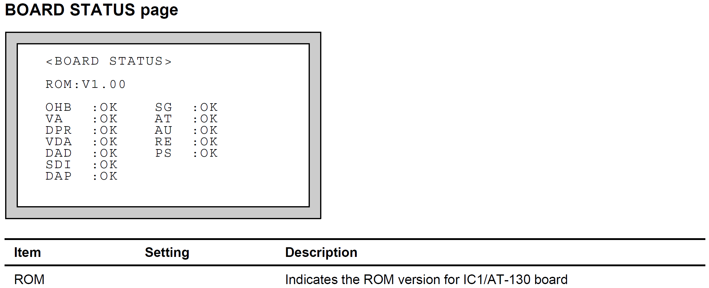

I just flipped through the service manual for a HDW-F900 and there is no 'AT' board anywhere in this model. Other models like that HDC-9xx series do have such a board, and the version would be shown in the menu if that were the case.
F900:
IF = Camera system controller and fan controller
SV = Servo controller
SY = VTR system controller and timecode functions

So then i wonder what Sony means by that? I would understand the error more if this was third party software for the cameras but it was made by sony for sony cameras so whats the deal? Am I out of luck to think ill ever be able to use CVPeditor with my F900?
