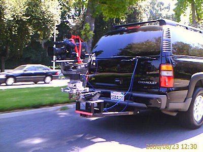

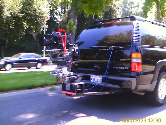

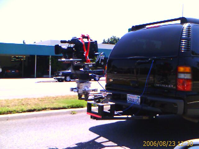

Random XDCAM HD Spotting in my neighborhood
Barely worth a post, but just a weird little bit of a story.
Returning home around noon from Burbank just 45 minutes ago, and realized 2 cars ahead of me is a black Tahoe with a rear facing stabilizer mount and remote head. Not that noteworthy, as you see production vehicles on their way to shoots all the time in my neighborhood, sometimes the cameras are mounted on the pictures cars already, etc etc.
Anyway, as I pull up to get a better look, I realized it was a 350 on the remote head! Kinda odd I thought, as XDCAM HD is still very much a "wha?" to most production people, even in Los Angeles. THEN I realized the tally light was on and he was rolling on me. Yow.
I have no idea what they were doing...my neighborhood is pretty but all they were was driving down the street rolling and following cars passing them, etc.
For the curious, the mount is something Chapman makes called the Super VI. It operates like a single section of steadicam arm, except it's motion is limited to strictly up and down. On top of that, there's another stage that slides laterally. Both together do a pretty good job of smoothing out a vehicle.
