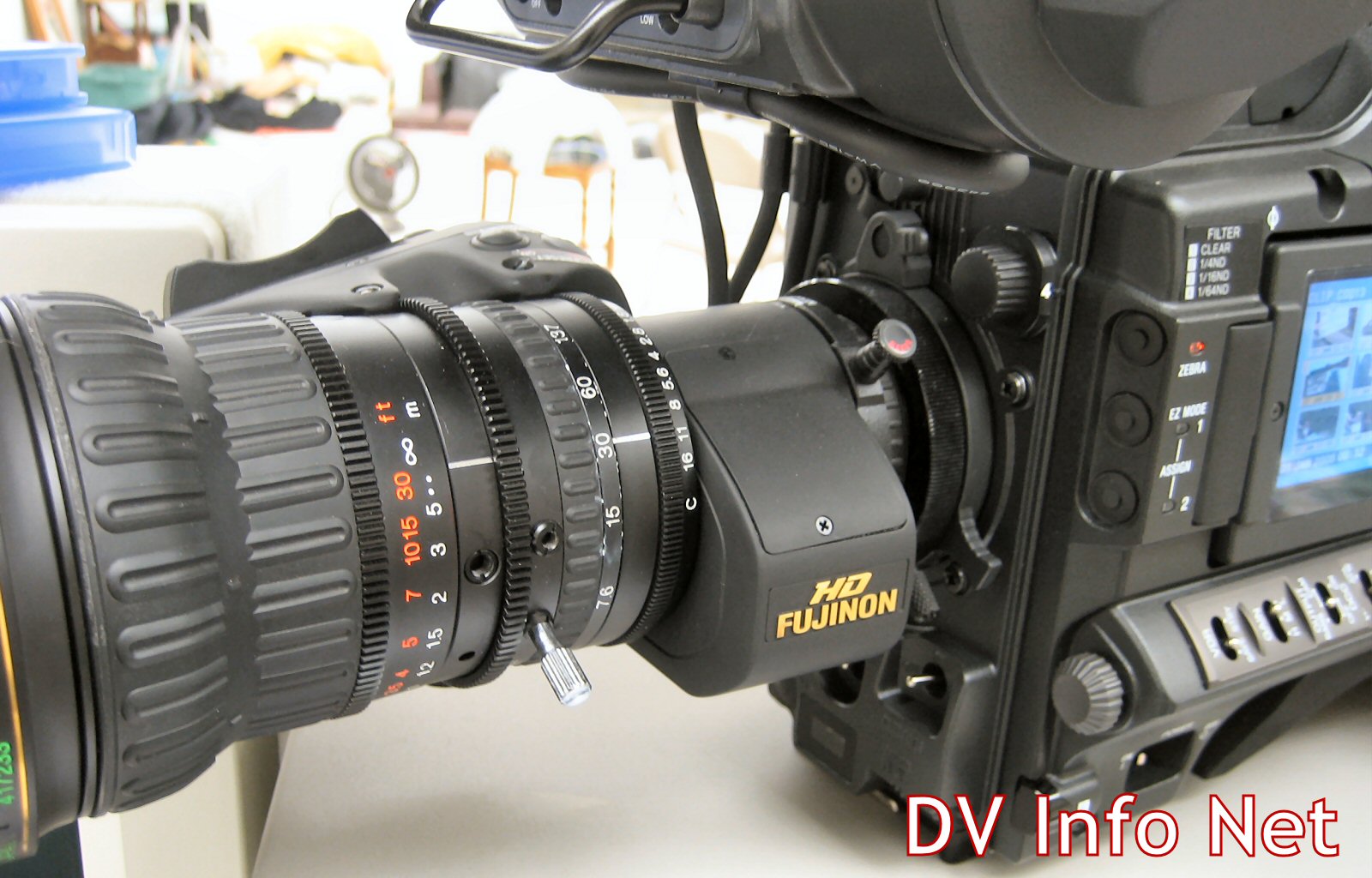

For our Texas HD Shooutout we had to resort to a 2/3rd-inch adapter on an F350 that Scott Cantrell brought up from Houston (this was after Mike Devlin had to head home with his F350). Here's a pic. Thought I had a pic of the adapter by itself but I can't seem to locate it right now. Nor can I recall if this adapter had an optical element, but I can easily find that out.

The adaptor doesn't have an optical element. The focal length of the lens also multiplies by 1.37 with the adaptor attached.
Despite this magnification I would recommend using it with 2/3" lenses over getting 1/2" ones simply because 2/3" lenses will last you longer and allow you to 'upgrade' to a 2/3" HD camera later.

There was no glass in the adapter, Chris. I was the one who dismantled the camera at the end of the shoot (remember me asking you where the adapter's cover was).

I only know of two adaptor. One made by century optics (schneider) and one by Canon. The adaptor shown on the picture looks exactly like the one sold by Sony (actually made by Canon) which I have. It does have glass. If you are serious about making the f330/350 your prime camera, I would invest in 1/2" CCD lenses (the nice ones wiht doubler). I found the adaptor to be a less than satisfactory solution for the reasons bellow:
- to much loss in angle of view
- to much loss in light sensitivity (at least 1/2 step)
- makes the camera forward heavy because it pushes the lens further forward.
Thierry.
