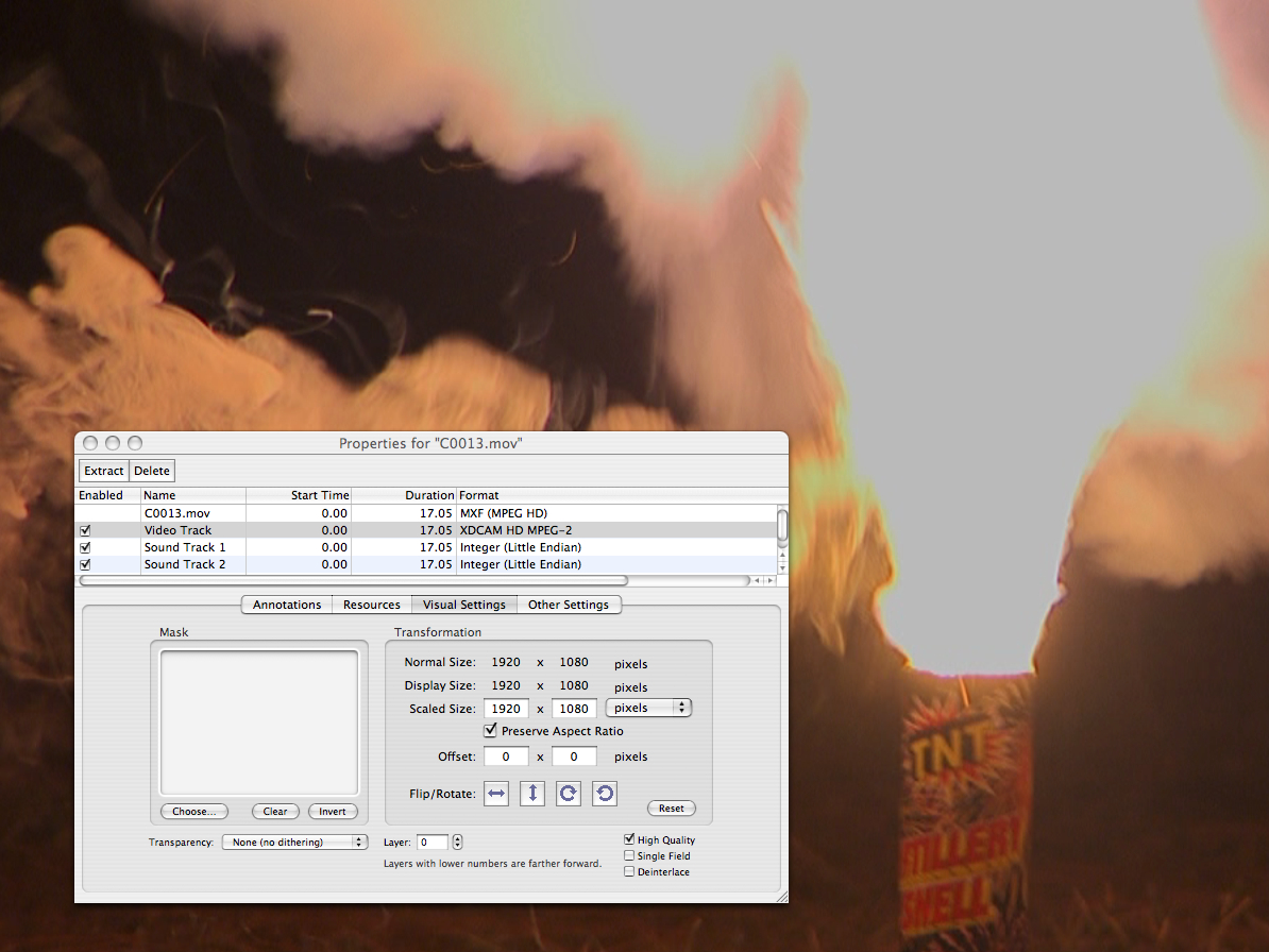

OK, I have been doing some tests. Although they say it only supports clips in 25mb mode, I have imported a clip that was done at 60p overcrank. The bitrate is halved to 17.5 VBR from the 35mb VBR quality setting because the vertical resolution is halved on overcrank. But it unwrapped just fine. I am going to upload it to the server.

Okay...here is the Quicktime file produced by XDCAM Transfer from the original MXF clip.
http://media.dvinfo.net/slomofireworks.movx
Do not click the link, use right click and save as or else you'll see a browser window full of garbage. Download then remove the 'x' from the end of the filename to play it.

Nate, when I play back an overcrank .MOV created by XDCAM XFER, its resolution is still reported as 1920X1080 with a VBR of 17.5mb
-gb-
Old July 9th, 2006, 05:59 PM   #13
Join Date: Oct 2002
Posts: 2,100
If you look at the properties of the mov in Quicktime Pro, it reads 1440x540.
When it comes to Quicktime files, there's the true resolution of the file, what it's been scaled to view at by the file creator, and then what the file was modified to play at by the user. It's really kinda crazy, there's can be 3 sizes in a quicktime file.
Anyway, the different apps report them all differently at times. Check the file out in QT Pro.
I was referring to QT Pro playback earlier, all three sizes are being reported at 1920X1080. Have a look.
-gb-

I know, here's the info panel you get when you Apple-I:
