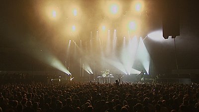

Well guys, thanks for responding, but it was a bit too late :-)
At about 1am Wed the night before the shoot, I went though and made some of my own basic settings:
1-Cine gamma 3 (the most gentle of the mid depressing gammas, I thought)
2-Knee of 80, slope of I don't remember. I just wanted the blowouts to be smooth and graceful. They were, but who knows if they were because if this setting.
3-Detail I left alone. Default seems to be in a decent place...but could be lower for certain things.
4-Black gamma of 40, which lifted the blacks a little bit like I wanted.
Looking at last nights footage after I got home (at 1am again!), it looks like I did what I wanted. There's a little detail still picked up in the dark corners of the frame(s), and when the crazy concert lights blew everything out, it still all looks very good.
Ingesting 12.5 hours of stuff into FCP now. Here's a grab and some pics:
http://homepage.mac.com/nweaver/XDCA...ncert%20Shoot/
7 camera XDCAM HD Shoot on Wed, need some pointers on gamma and knee-c0001.jpg
My Work: nateweaver.net
