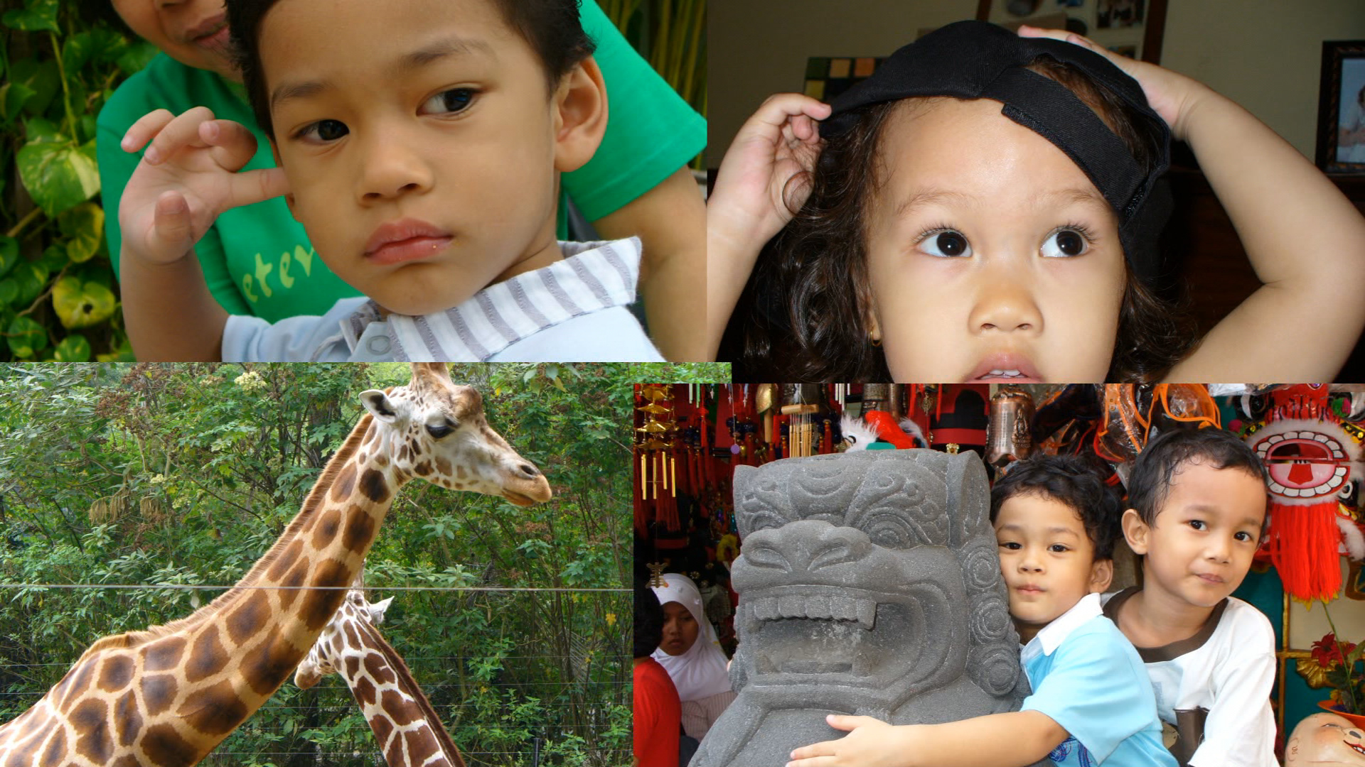

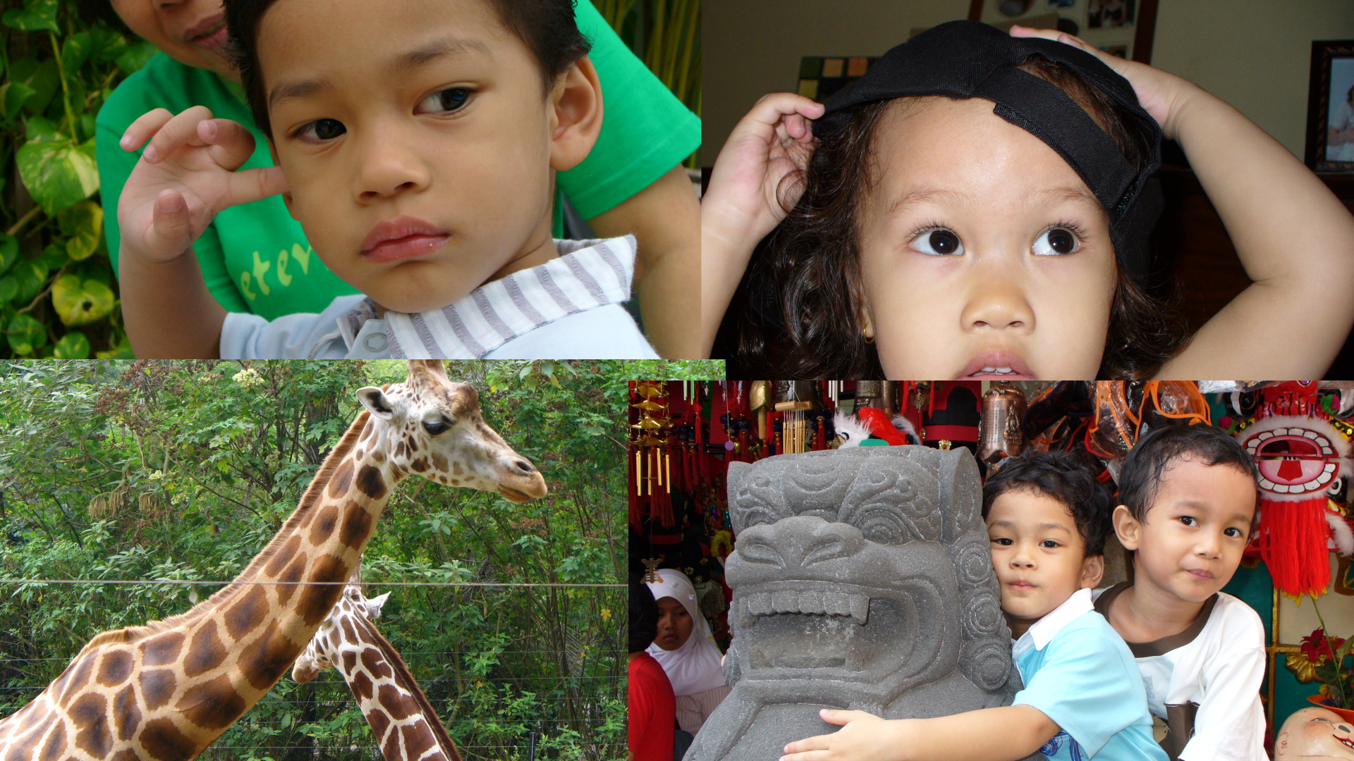

notice the green t-shirt at upper left
notice the reds at lower right
you'll have to download the full sized image. Color difference in small-scaled image here are not very evident.
these are hi-q jpegs.
Vegas 7.0b Sony MXF export alters the colors-orig.jpg   Vegas 7.0b Sony MXF export alters the colors-dvcpro100.jpg

Vegas 7c free update has now been released which fixes this colour shift problem.
