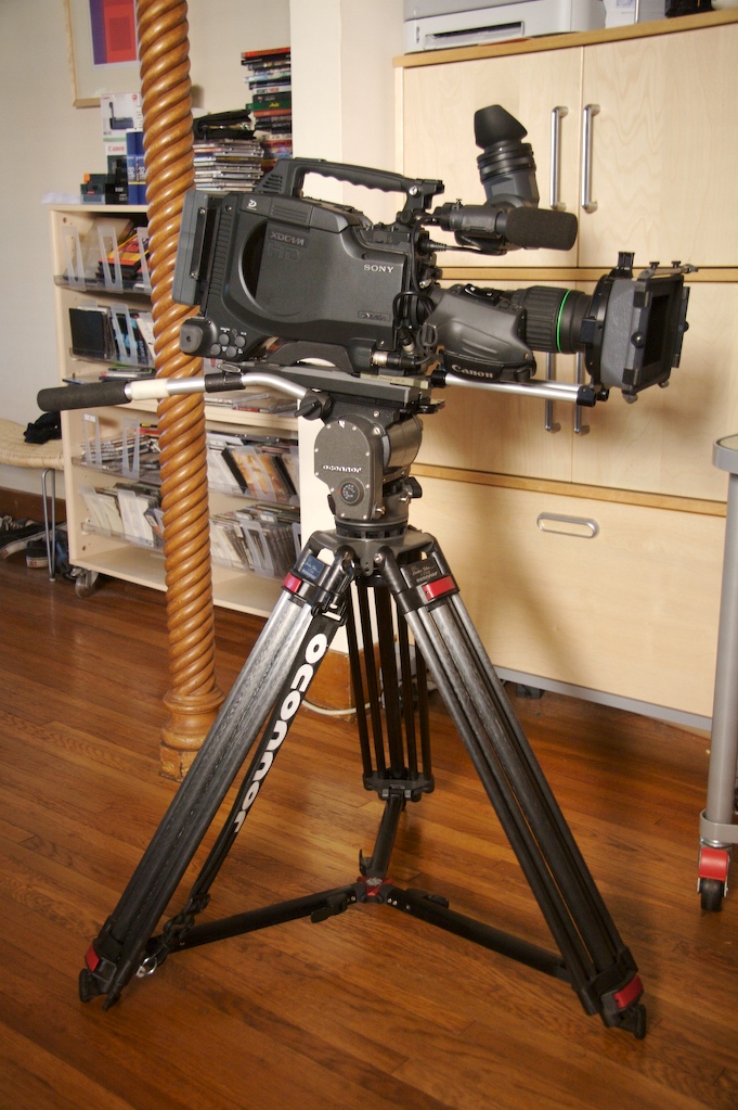

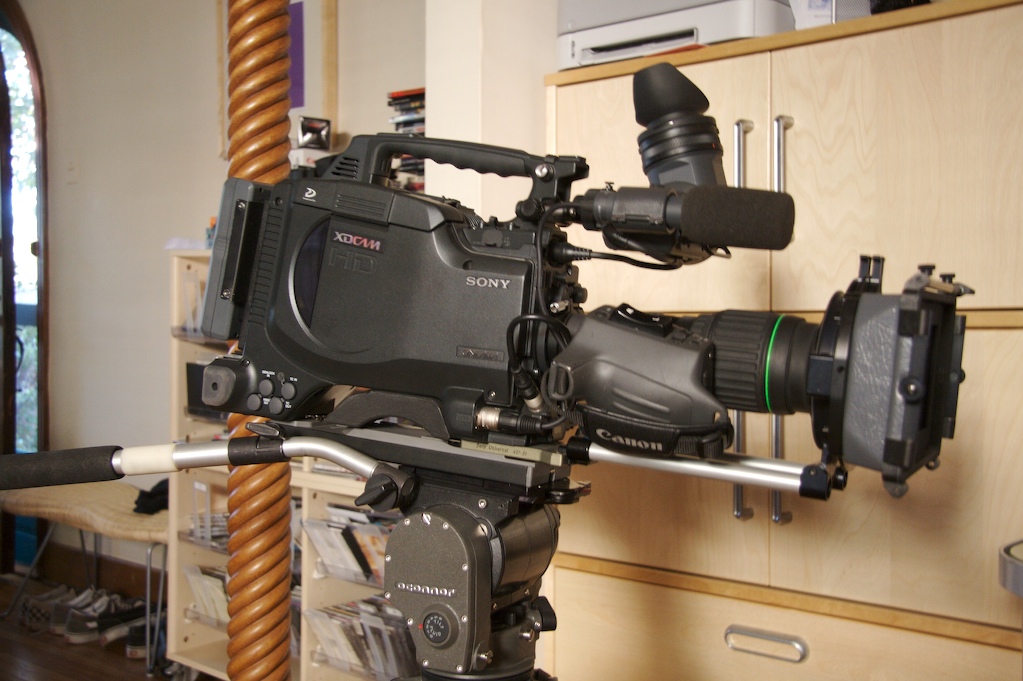

Yeah, after shopping for a week and trying a lot of different things out, I could write a book about it. A boring book, but...
I wound up buying an O'Connor 1030B and 25L carbon legs. It was not cheap, although it was cheaper than the equivalent rig new from Sachtler.
After driving around and trying a lot of Cartonis, Sachtlers and others, I realized that O'Connors was the one head I could go on the long end of the lens with, and get perfect moves and resistance from...Sachtler was close, but O'Connor was better.
