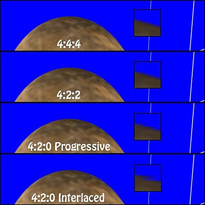

I also agree. Interlaced 4:2:0 is much worse then progressive 4:2:0. Progressive isn't really that much harder then 4:2:2. Check out the sample image I have attached that shows what the different levels of color compression can look like. Progressive 4:2:0 is really a very nice format because really the chroma samples are just 2x2 pixels in size. This can give you some very clean results because the horizontal and vertical have the same ratio of samples. If you have a tool to resample or slightly blur the two chroma channels then your results will be even better.
Note: This image was created by creating a RGB AVI file and encoding it with a mpeg2 encoder into the different formats. I then took stills from the video files and put them together in this image.
Latest thoughts on using F-350 with green screen-chroma-sampling-examples-2.jpg
