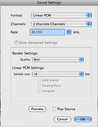

Ingesting Footage to Final Cut Pro
Hi All.
I am running 10.5.4 on a dual G5, with the latest Final Cut Pro version 6.0.4 with latest version Sony plugin - 1.01. I have been having the same problem with clips that are imported from the Sony Memory Recording Unit. I have only been using the Sony Cards that come with the unit, I have two Z7's which came with two 306x 8GB cards in the kit as a promotion. I am shooting on PAL in Australia.
Seems as though this is not an isolated case, and my thoughts would lie with Sony's plugin not being completely compatible with Final Cut Pro or the way that the camera handles the files. I am offering the following information as a workaround, but this is by no means an ideal situation as it takes a lot longer and the audio is not contained in the quicktime file.
I get the same exclamation mark in the Log and Transfer window when importing some files. In this following example, you know that you have only recorded one file, as during recording the card was recorded to continuously without stopping, until I stopped it manually. I use the card as a changeover from tape to card and then back to tape, but in this case, I left the card go and keep recording until done, as it was only about 10 minutes of footage. On second camera the operator put in a new tape, so this is the one which is having the issues. From that card, one file shows up correctly in the Log and Transfer window. But when you look at the folder structure there are 3 M2T files on the card (could be more, but this is a real life example).
I know this is because of the 4GB file limit (Fat 32, yukky), but when changing tapes it generates another M2T file and most often loses a few frames or even seconds from the recording.
I then opened this footage in MPEG Streamclip and exported using HDV 1080i50 unscaled with no sound. Why not import the sound? The sound I was recording was from two distinct channels, as I needed it to be separated audio - one from the mixing console and one from live sound. I then export the audio using File>Demux>Demux to AIFF... Once this is exported I open the sound in Quicktime and export again as a .aif file, but making sure that I check the settings that requires two distinct channels otherwise I end up with a stereo interleaved or one mono mixed channel sound, which is not desirable at all. Once I have this one .aif, I simply place it in the correct folder or export to the folder I need (I put it in the capture scratch) and then drag into Final Cut Pro. Line it up on the timeline and there you have it, perfect vision and perfect audio. Only one problem is that with this apparent drop of files occurring on tape change, it sometimes loses a couple of frames or even a few seconds from between the sequential M2T files. This is really annoying and I cannot find a fix for this, I can only assume that one of the Sony cards I have is not working correctly or not keeping up and has to lose information occasionally. I think this may be an issue as to why the software can't handle the ingestion as well.
I have bought another 300x 16GB card, so I will test this as well and make another post. Has anyone had this issue before with regards to split clips and losing a few frames? Normally I would think this was only because it reached it's 4GB file limit, now I think it is because it fails when you put in the second tape and either the firmware on the camera or the software plugin for Final Cut cannot recognise this changeover properly. I am definitely getting a section of a few seconds where the card craps out and won't record anything until the tape gets going again. If I don't change tapes, it seems to work fine. But I still need to do more live testing to ensure it is only one card, as I usually record live events in tandem, I need to mark the cards to find out which one is failing on changeover or if they both are. Currently I have 3 cameras running, so I am not worried, as there is a fail-safe off to another camera, but it is still time consuming and annoying. Sorry for the long post, but I hope this was beneficial for some.
