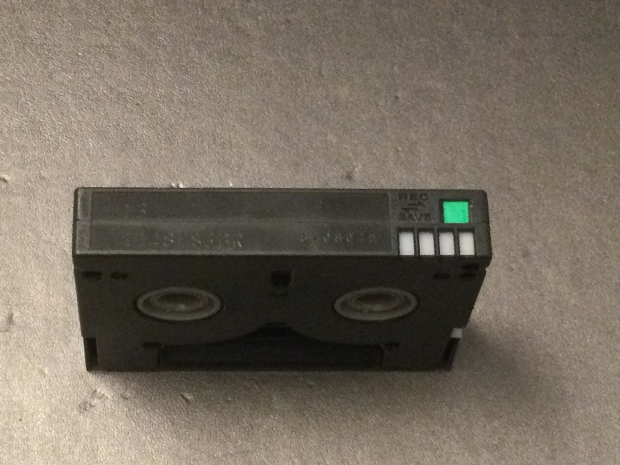

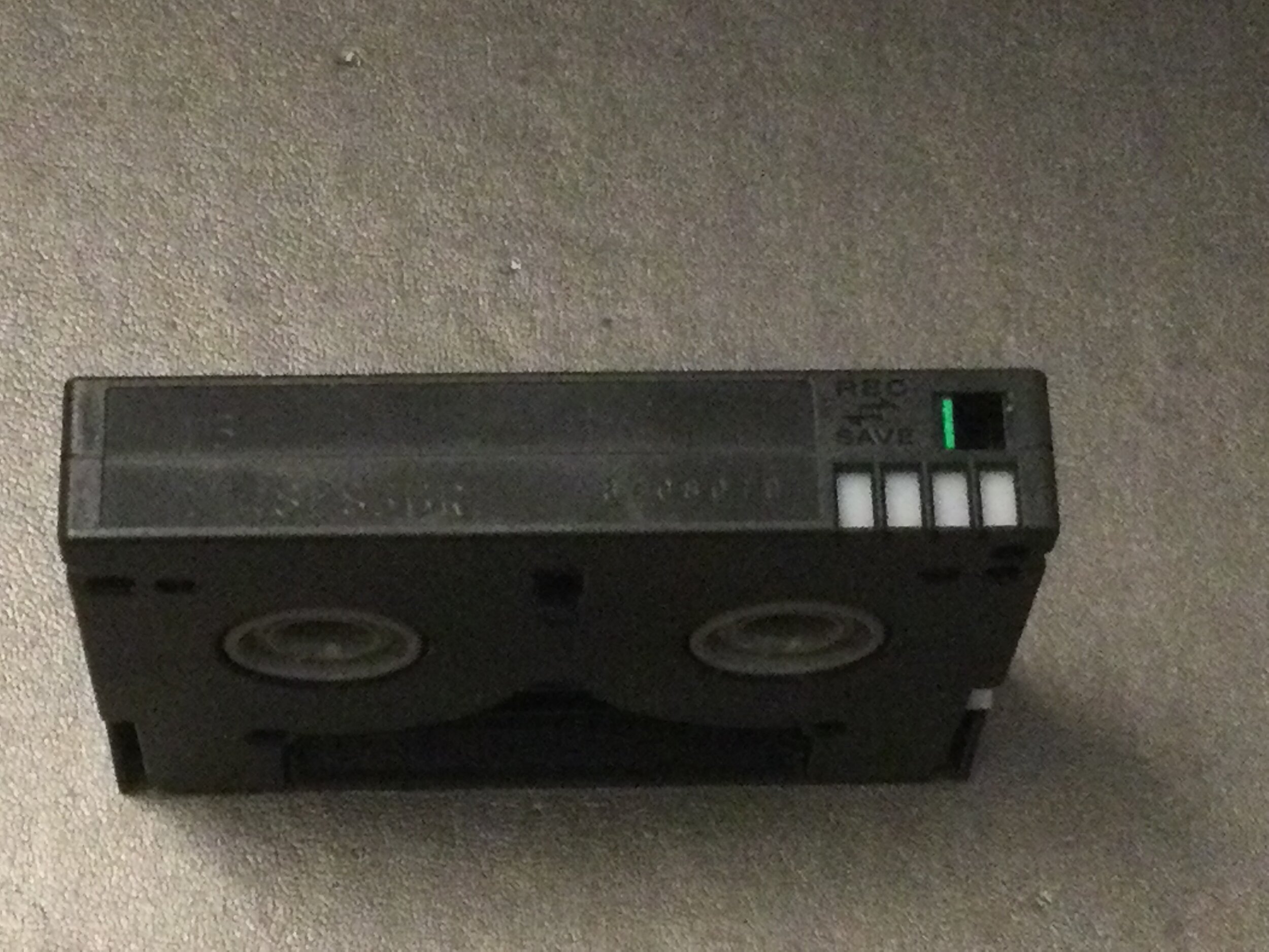

The first one to check is that the record tabs on the rear edge of the tape are closed ( no hole left ) to allow recording . These are just like the tabs you may have known on VHS tapes , which you snapped off if you wanted to prevent a valuable recording being erased , only on DV cassettes the tab slides to one side and can be slid out again .

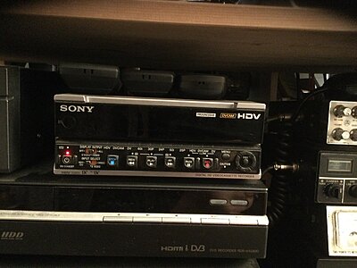

I’ve had a few of these decks in the past , and still have and use the HVR-M15 , which is the HDV version of that deck . See photo .

Also see the pictures of the rear edge of a mini DV cassette . The one with the green tab showing can be recorded on , the second picture showing the tab slid out of the way cannot be recorded on . You may also see rec and save faintly imprinted on the plastic .

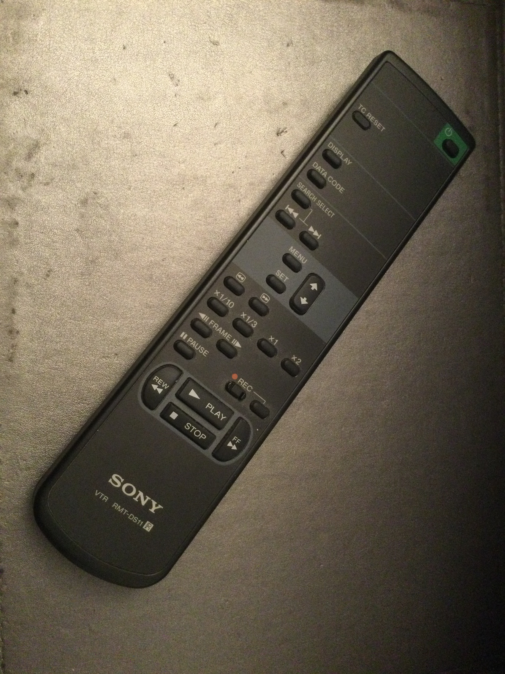

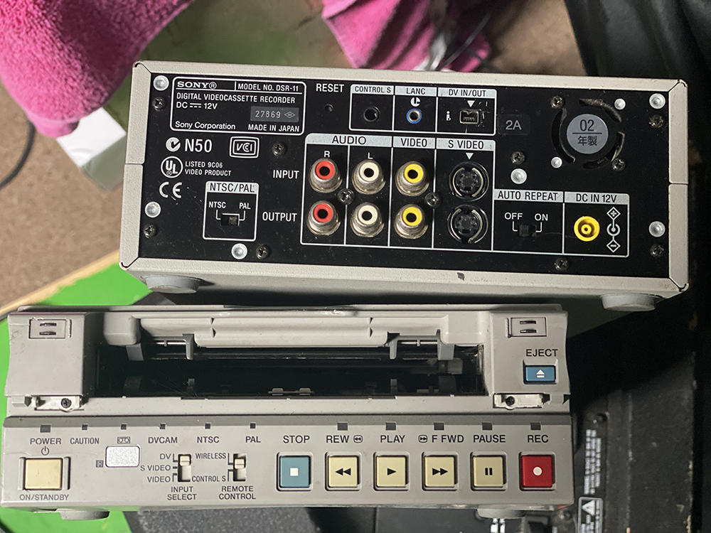

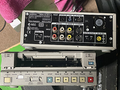

Finally , just looking at Paul’s picture of the DSR11 , there are no menu controls , so you would need the remote control , which was somewhat similar to the one I have for my HDV deck . Your user manual will give the type number of the remote , and if you search on eBay you might find one .

The Remote
