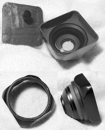

Has anyone figured out a lens hood for this lens yet?

After I bought mine, I searched around trying to come up with a lens shade. I dug through a box of hoods I had collected over the years. Found a Hasselblad Bay60 38-60 lens hood. It is a bayonet mount hood for some of their lenses from 38mm to 60mm. I ran two layers of gaffers tape around the inside of hood opening, which covers up the bayonet. It press fits on the VCL-HG0737C lens perfectly, sliding right up to the gray rubber ring on the lens, and stays put. I made a cap out of foam core and gaffers tape.
Here is one http://cgi.ebay.com/HASSELBLAD-BAY-6...QQcmdZViewItem
This is just to show the item, I am not advertising an auction!
Attached are pictures of mine, both attached to the lens and not.
Cheers/Duane
