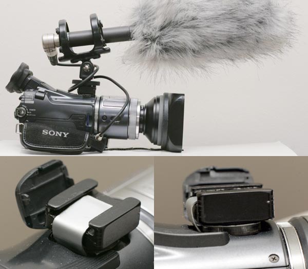

I use this on my HDR-HC1. The shoe parts include the post that slides into the AIS shoe, a set of washers that you use as spacers and then the shoe screws down onto the washers until it it tight and aligns with the camera.
I had to add one item because I use a Rode NTG-2 and xlr to mini-phono adapter. As you can see in the picture that is attached, it sets way off center, and the shoe and mic would tend to turn with the weight of the microphone if I tipped the camera. I could not tighten the shoe enough.
My simple fix was to take a thin piece of sheet metal (actually cut from an old pcmcia modem). I cut it to the width of the groove in the bottom of the shoe area, tapered it to the width of the AIS shoe. I then slipped it into the AIS shoe, slide the adapter on top of the metal and tightened it. I then bent the sheet metal and slid it into the adapter shoe and mounted the microphone. This kept the shoe/microphone from turning more that 1/2 an inch or so. It works great. I leave the adapter shoe on all the time.
