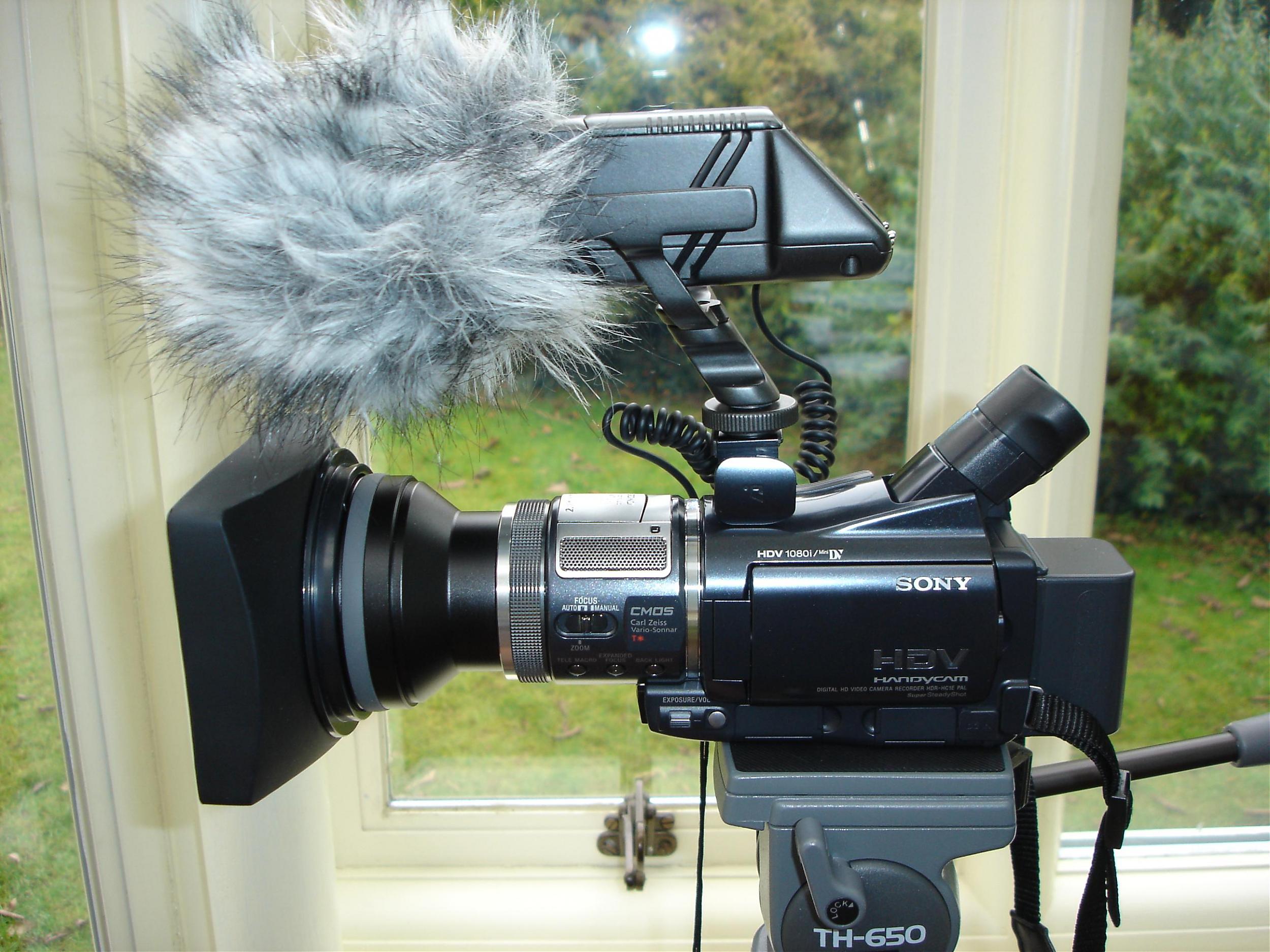

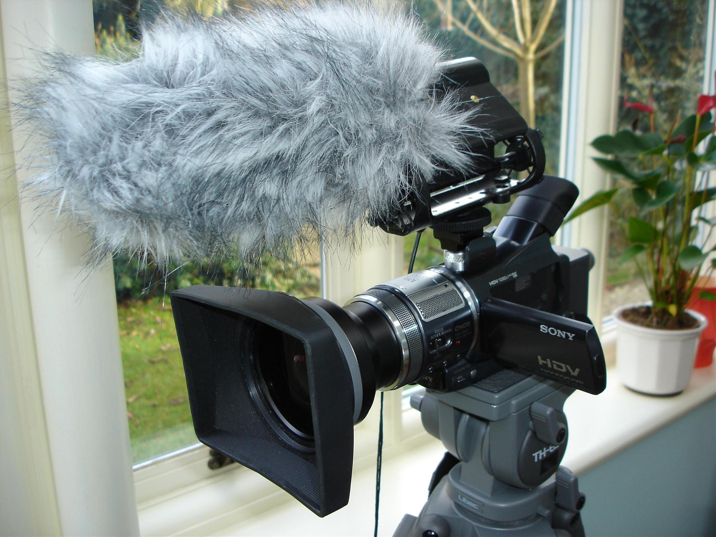

Pics of Sony HC1 & VCL-HG0737Y Wideangle & Cavision LH77 Hood
No worries Tony - this is a great place to bounce ideas around with fellow videographers before you spend any hard earned cash!
Before this thread goes off on that tangent though it gives me a great excuse to upload a couple of pics of my HC1 with that Sony VCL-HG0737Y Wideangle and Cavision LH77 hood. Many will recognise the Rode Videomic & Stereo Videomics (hiding under those dead cats!), mounted with a B. Hague (Nottingham UK) Sony Shoe Adapter. Tripod is Libec TH-650. Battery is the Sony mid-sized one (NP-QM71D) as I find these suit me best.
Rode VM on left and SVM on right in pics below (for those that don't know)
