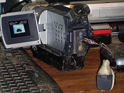

Made Another Charger Adaptor for HC9
I made one today that has all 3 contact points on it, so I can use it to charge the NP-FH batteries with my other Sony camcorders and mini-VCRs. I used it tonight with a 7-year old Sony Digital8 camcorder, to charge both my FH batteries. Now, I won't have to use the HC9 itself for charging, even if my Sima charger were to quit working. And it will let me charge two at one time, without having to buy another charger. Here's a picture of it, while it's sending power from an FH battery to a TRV730, prior to charging it up again. It's in the lower-right corner. It isn't pretty, but it works. That's a surrogate battery in the camcorder, which is the hollow shell of a worn-out FM battery. I removed its innards and soldered the lead wires from the adaptor to the contact points from the inside, passing them through 3 drilled holes. I used a hacksaw blade to cut the shell open along its seamline and fused it back together with shoe goo.
I'll also make another adaptor, using a defunct NP-F330 battery that came with my VX2100. This will allow me to use either this camcorder or a Digital8 GVD-200 VCR, which also takes the NP-F batteries, as additional chargers for the NP-FH batteries. My MaviCap floppy-disk recorder also recharges the NP-F batteries. It seems that the small-capacity lithium batteries that come with Sony camcorders are typically poor quality and don't last very long. Turning them into surrogate battery shells provides a good use for their remains. I've developed quite a collection of old video batteries and their parts in my re-cycling bucket, that is destined for the local receiving station for such things. And I'm aware that my keyboard could use a good cleaning.
