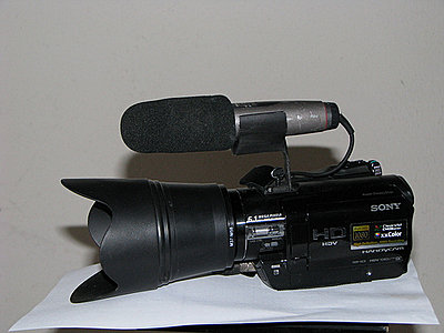

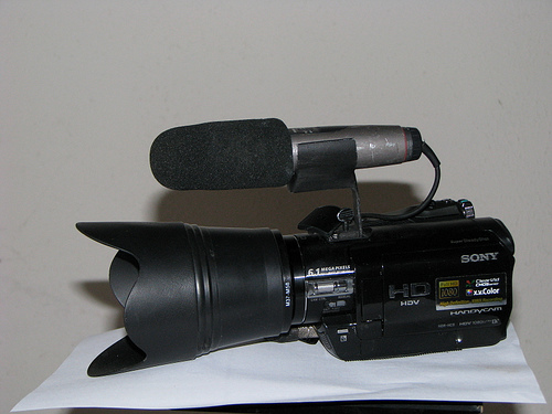

I use a Sony VCL-DH1758 telextender almost constantly on my HC9 and a Raynox HD-2200 on occasions when I need more lens power. The DH1758 is designed primarily for use on Sony digital cameras of the H-Series, but it works very well on many other cameras and camcorders. I mount it with a 37mm to 58mm step-up ring I got from B&H. It has 1.7X and causes vignetting on the HC9 only below 30% zoom. It is very sharp optically, but costs only about $100.(U.S.). Its relatively large size, is what allows it have such a large portion of the zoom range be vignette-free. It weighs 8 oz.
The Raynox HD-2200 (a slightly different model number may be available now, but it's the same lens) gives 2.2X power and mounts directly on the 37mm threads of the HC9. It is at least as optically sharp as the DH1758, but causes vignetting below about 60% zoom on the HC9. It weighs 4 oz.

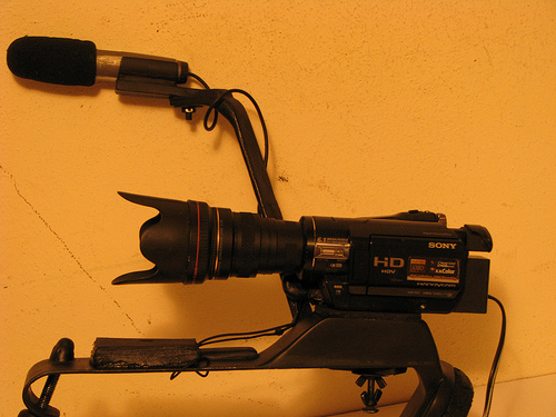

Here's photos showing the two telextenders on my HC9. I made the butterfly hoods from fiberglass. The mike is a Sony stereo ECM-MS907, a good match for this camcorder. The DH1758 is on the left. I no longer use the internal mike or one mounted on the camcorder's shoe, as the tape mechanism is too noisy. Using a mike on the extended arm is the only way I shoot with this model. With my steady-mount, I have no trouble with camera movement at full zoom. There's more pictures of it a few pages back on my Flickr album and many HC9 videos on my Vimeo album.
