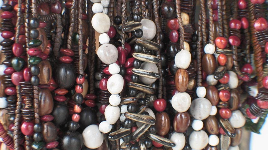

Bill,
Check out this frame grab taken with the A1U and the VCL-0637H conversion lens and see what they mean about the blurred corners. It's very annoying indeed...
Wide Angle lens for HC1/A1U-colares.jpg
Mauricio Galdieri is offline   Reply With Quote
