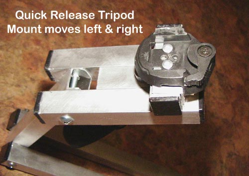

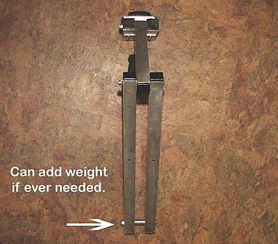

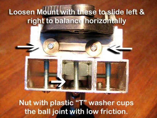

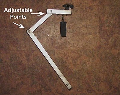

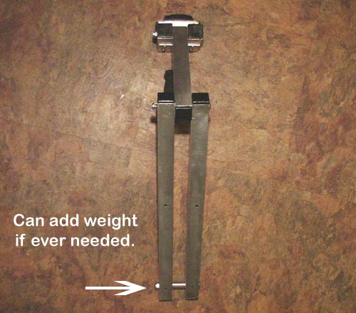

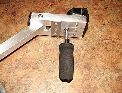

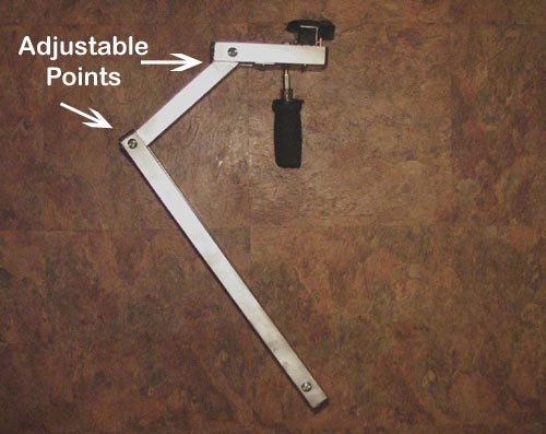

Parts I used:
1" Aluminum Box Channel
Tripod camera mount from old tripod
Handle from old monopod
1/2" balljoint from mini tripod (this serves as the "gimbal")
3/4" Nut
Teflon "T" washer from a toilet water supply hose (served as a relatively low friction socket for the balljoint.
1/8" sheet metal to use as a bracket on the bottom of the sled. Used poprivets to secure the sheet metal to the sled.
And a variety of nuts and bolts.
Use the pictures as a guide and the forums mentioned above... this thing flies really well and was used with one of my HC1s till I bought a glidecam 2000. The pipe systems and many other homebuilt jobs look like crap--so I built this one that works and looks much better.
BTW, position the middle and lower arm to control the vertical angle during balancing... and make sure you secure the tripod mount VERY WELL so the camera doesn't fall off. I used some aluminum angle channel and pop riveted the tripod mount to the angle metal, then cut a slot for the two screws to slide through it and secure with the nurled nuts.
Good luck.
self made a little steadycam for sony hc3-01.jpg   self made a little steadycam for sony hc3-02.jpg
self made a little steadycam for sony hc3-03.jpg   self made a little steadycam for sony hc3-05.jpg
Jerome
