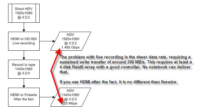

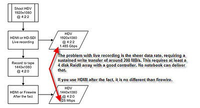

I've said this before, but may have been missed in the sheer number of very informative posts here, so I will try to explain again.
Look at this image: http://www.millcon.nl/Harm/HDMI.jpg
Old March 25th, 2007, 09:02 AM   #10
Location: Niagara Ontario Canada
Posts: 1,121
Yes, I can see with the 4:2:0 firewire compared to the 4:2:2 HDMI, it is going to be better off with the HDMI card. Hopefully other manufacturers come out with their own knock-offs and bring down the price.

Old March 25th, 2007, 03:47 PM   #11
Posts: 1,832
David,
My message maybe was not clear enough, but once your shoot is recorded on tape it is stored as 1440x1080 @ 4:2:0 and there is no way you get it back to 1920x1080 @ 4:2:2 format. The info has been lost forever. Even a HDMI connection can not change that fact. HDMI is just a transfer protocol and in essence no different from fire wire, once the data has been stored to tape.
ONLY when you capture LIVE, BEFORE RECORDING to tape can you use HDMI or HD-SDI to it's fullest potential, uncompressed @ 4:2:2 but that requires massive storage potential as indicated.

Old March 25th, 2007, 04:23 PM   #13
Posts: 1,832
Correct, but I would be interested to hear the specs of your notebook that supports a sustained transfer rate of 200 MB/s (that's MEGA BYTES). I know that a 2 disk SATAII Raid0 @ 7200 RPM will NOT fit the bill, not even close. Even a 2 disk Maxtor Atlas 15K II SCSI array will not meet requirements. If you double click on the thumbnail in my previous post, legibility will be improved. Read my remarks.

Posts: 1,121
Ok, so only with those speeds I will get the 4:2:2. Now I am clear. No my laptop does not have those speeds.
