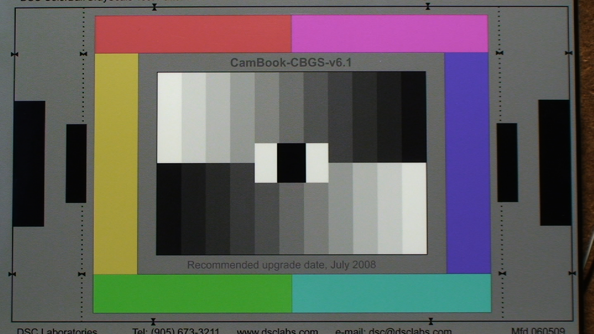

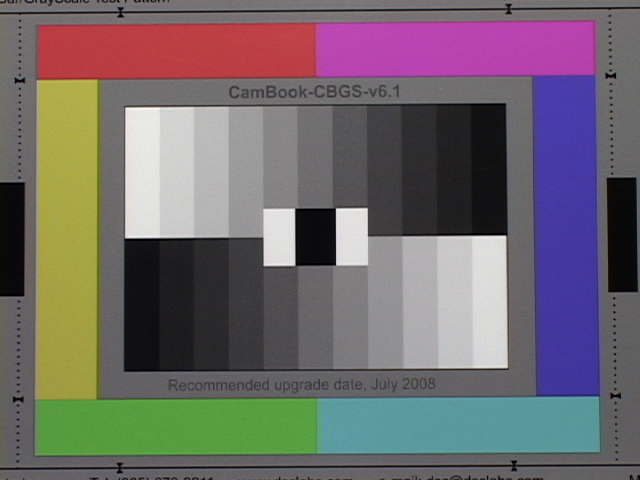

Color Chart jpegs
Here are some color charts for you to look at and make your own judgements.
For comparision one jpeg is for the PD170 at 0db f6.8 which is where the auto exposure set itself.
The first HD1000 jpeg (test-2) is the camera shooting the white balance card after the white set.
The second jpeg is of the color chart as the camera set the exposure. It seems to be between f2.8 and f4. It is hard to tell especially since the manual exposure will not let me go to the same exposure the auto exposure can go to. It's also hard to tell what the increments are.
The third jpeg is of a resolution chart which I couldn't get square with the camera enough but it should give an idea.
The fourth is a (blurry) photo of the LCD while the camera is shooting the chart in "test-3" just so you get an idea of the LCD overscan which is considerable.
First shoot, first impressions for HVR-HD1000-test-chart-pd170.jpg   First shoot, first impressions for HVR-HD1000-hd1000-test-2..jpg
First shoot, first impressions for HVR-HD1000-hd1000-test-3.jpg   First shoot, first impressions for HVR-HD1000-hd1000-test-4.jpg
