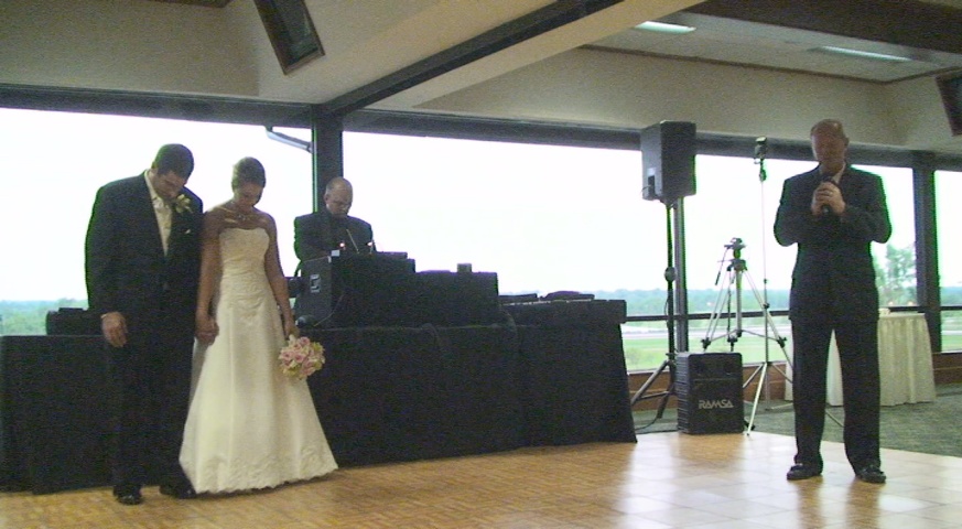

grain removal in a 64-bit install of vegas 9
So I am wrapping a wedding edit (Shot on my HD1000U and PD170) and have a few scenes with horrendous color noise issues. I have upgraded to a Win 7 64-bit machine and from what i can tell, NeatVideo is only for a 32-bit install. Do you guys have any recommendations for correcting this? Thanks!

NeatVideo Pro has a 64-bit version.
So I reached out to the technical staff at NeatVideo and here is what they had to say:
Pro : commercial version ($99.90); 32-bit AND 64-bit;
32-bit plug-in works in Vegas Pro 9 / 8 / 7 / 6 (32-bit)
and Vegas Movie Studio 9 / 8 / 7 / 6;
64-bit plug-in works in Vegas Pro 9 / 8.1 (64-bit)
So, the 64-bit plug-in, which works in Vegas 9 Pro 64-bit, is currently available only in the commercial Pro edition.
If you want to evaluate the quality of the Neat Video noise reduction before purchase please consider testing the free Demo plug-in in a 32-bit version of Vegas. Both 32-bit Vegas and 32-bit Neat Video Demo plug-in can be installed and used in any Windows, 32-bit or 64-bit one.
We will probably add 64-bit support to non-Pro editions of Neat Video plug-in in the future as 64-bit Vegas and Vegas Movie Studio become more widespread as compared with 32-bit versions.
Hope this helps,
Vlad
Support, Neat Video team, ABSoft
mailto:support@neatvideo.com http://www.neatvideo.com
They also sent me this link for more information.
http://www.neatvideo.com/news.html#N...-bit-2009-6-26
So the lesson here is, as great as DVInfo is for information, sometimes you need to go to the source. I should also note that I got both replies in approx 30 min after sending inquiry on a Sunday night. Talk about great support! Top notch product and support, gotta love it.
