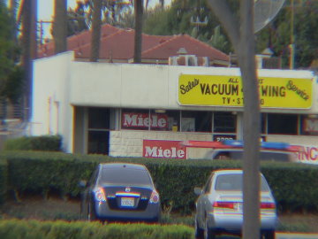

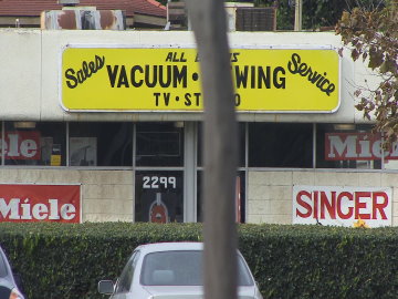

here are two snap shots of with and without the raynox 7062, both were full zoom, its obvious with the raynox on the zoom has to be limited
Hugh Mobley is offline   Reply With Quote
appalling! how about full wide?
leslie
Leslie Wand is offline   Reply With Quote
Old November 26th, 2007, 02:13 PM   #11
Location: Placentia, Calif
Posts: 549
This is from the Raynox site:
**The lens is made compatible in using with a 20X zoom lens. However, when zoomed up to the end of the telephoto with the lens on, the image quality of the picture will be lowered except the center area, and the deterioration of resolution power at corners will occur.
so my snapshots are to be expected, I didn't expect it as bad as it was. My recent clips at about 70% zoom were very good
