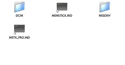

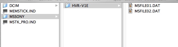

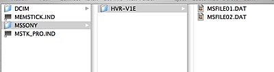

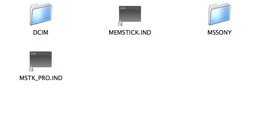

I dont think it will work the way you suggest. The extension for the V1E seems to be .DAT
Here are some screen grabs of the folders in my memory stick.
folder1.jpg shows the main folder where DCIM contains the still shots if you take any.
In MSSONY folder you can find HVR-V1E folder and there are the camera and picture profiles as .DAT files.
Unfortunately I cannot differentiate which is picture profile and camera profile, I have seved both and gave names as well, but apparently they were saved only as .DAT
Anyone here with an idea how to save the settings more usable?
