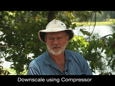

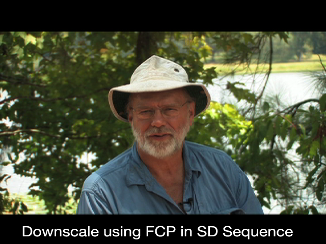

Sure. Final Cut Studio 2.x is supposed to down scale HDV by simply placing the clips on an SD timeline. This yields disappointing results exhibiting a great deal of aliasing (regardless of the timeline codec). I have discovered that Apple Compressor does a much better job of down converting in both wide screen and letterbox. See the attached images for a comparison (notice aliasing in his hat in the second image).
Here are two work flows
1. Edit the sequence in native HDV and export the program in the native codec (no re-compression). Then bring the exported HDV movie into Compressor for down conversion and final output. Please note that the exported timeline must be a self-contained movie. HDV does not support "by reference" exports.
or
2. Bring the captured HDV clips into compressor and batch process to SD, then edit in SD.
sony HVR-V1U  hdv to dv down convert-down-convert-compressor.png   sony HVR-V1U  hdv to dv down convert-down-convert-fcp.png
