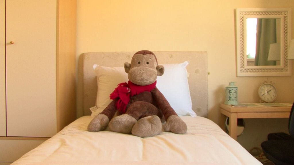

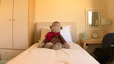

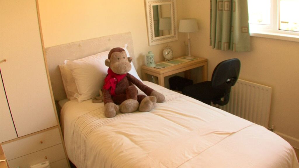

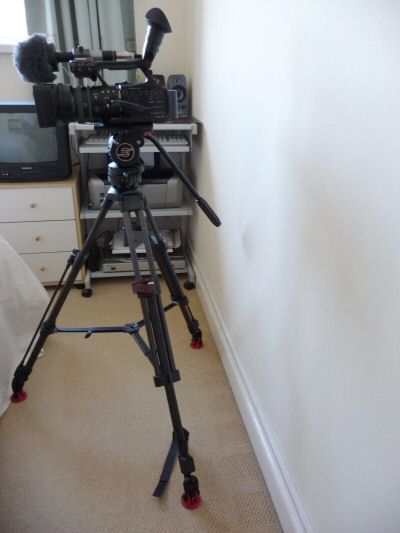

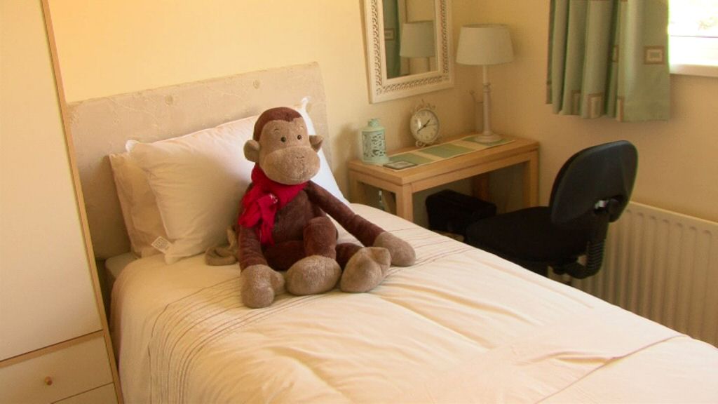

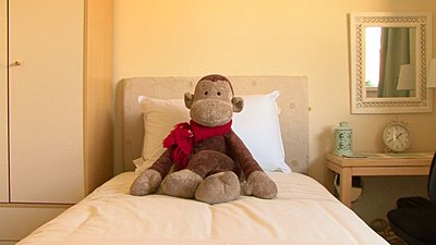

OK, so here's a not so scientific test. I'd like to thank Oscar, my model, for helping out. Note that the V1 I use is identical to the FX7 in the optical department.
I've attached a few pics:
- w-lens-wa1 has just the stock V1 lens
- w-lens-wa2 has the 0.8x lens on
- w-lens-wa3 is another angle (in the corner of the room) with the 0.8x lens on
- w-lens-wa4 is the same shot as WA3 with just the stock V1 lens.
- The last pic shows how close the camera and tripod were to the wall. It could move a few cm closer, but it would be a bit awkward.
The room is 2.8m by 2.8m.
There's a fair bit of barrel distortion with the Sony WA lens. I'm sure fact that it is zoom-through is good for interviews, as you get a lot of scope with that 20x lens to re-frame without having to fumble round with the lenses. You can also see that, as predicted, it doesn't go very wide!
I'm kind of glad I don't shoot interviews, especially not in a small room and especially not with the Sony wide angle!
