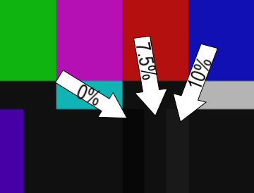

Step 1) Set up the LCD and viewfinder properly. Turn on camera bars, and adjust brightness so that the 10% bar in the lower right is dark grey, just distinguishable from the 7.5% bar, and the 7.5 and 0% are black.
