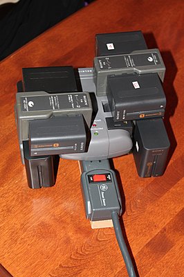

Question about the Sony batteries and what others are doing, I may use 2 batteries for cameras and 2 batteries for lights during a typical wedding so I bring 8 charged batteries. As I prepare for the following wedding, I simply charge all 8 batteries. I am wondering if this could be harming batteries that were charged a week ago and not used?
I have a setup which allows me to charge all 8 at same time, very handy, photo attached.
Sony NP-F, L Series charging/using-img_4739.jpg

I found over the years the Sony batteries hold their charge pretty well. If you're doing 1 or 2 jobs a weekend then you probably don't need to charge the unused ones. You might lose a little time maybe 5 or 10% (guessing) but with the number of batteries you carry that shouldn't be a problem.
Now that I've said that, I have to admit that even today using V-Lok for my main camera and Sony's for my light, I still throw them all on the various chargers after the job even if I don't use them. Force of habit.
You might think about rotating the batteries for use. I have always numbered mine so I might start with #1 and the next job start with #2 etc. That way they all get used at one time or another.
