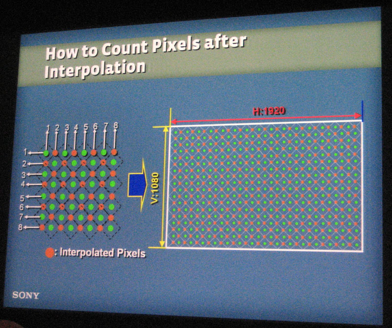

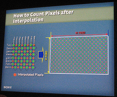

I just attended the press conference where they announced the V1, and Hugo Giaggioni (Sony CTO) gave a technical presentation about the sensors. I really haven't been following all this, so maybe it's old news to you? But I've sent a lot of info to Chris which I'm sure he will eventually put online.
In the meantime, you might find the following to be of interest:
IBC: Sony announces HVR-V1e-img_0167.jpg   IBC: Sony announces HVR-V1e-img_0169.jpg

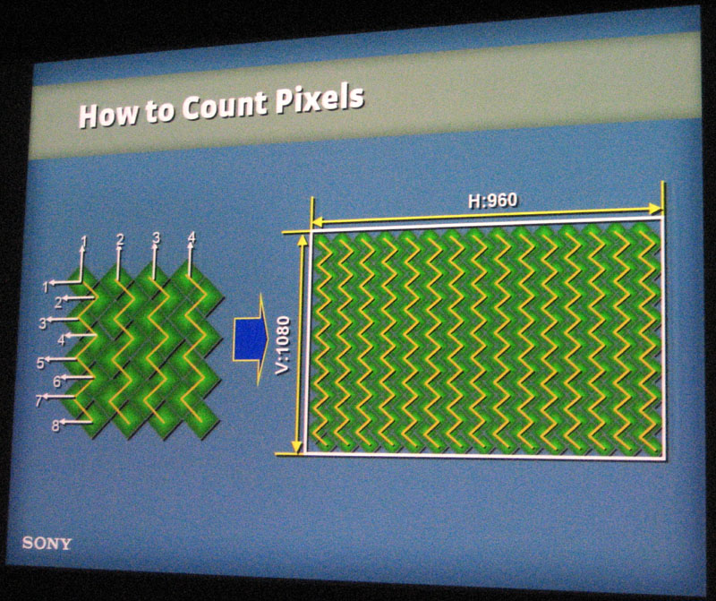

That is how I guessed they were counting them, and the problem is, its not self consistant. If you use the method in one direction, you get 960x1080, if you use it in the other direction, you get 1920x540 for the full sensor.
Either interpretation is true, and neither is indicative of the performance, its just a convenient method to make people think they can compare the performance directly with the FX1 and its siblings.

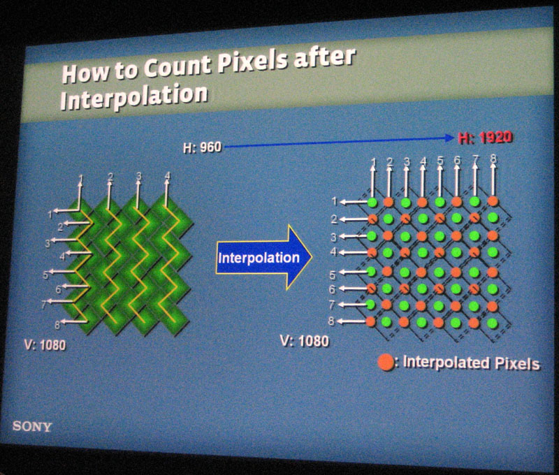

Here's another one:
IBC: Sony announces HVR-V1e-img_0170.jpg

Originally Posted by Marvin Emms
Thanks Boyd, you are a saving my sanity.
That is how I guessed they were counting them, and the problem is, its not self consistant. If you use the method in one direction, you get 1080x960, if you use it in the other direction, you get 540x1920 for the full sensor.
I think you mean 960x1080 and 1920x540; it's horizontal, then vertical.

Posts: 1,719
This kind of reminds me of a bayer pattern where every other green pixel is interpolated. In this case pixel 1 and 3 are real pixels while pixel 2 takes a chunk from 4 different pixels. So does this mean the luma resolution is kind of on par with what a single chip camera would do?
a single cmos camera may have a 1920x1080 chip but every other green pixel is interpolated from the bayer pattern. This leaves you with 960 true green pixels.
In the 3 cmos camera you start out with 960 but because of the way the pixels are lined up you get an interpolated result equal to 1920.
I would think the results would be somewhat close except for the chroma which would be better then the bayer pattern chroma.
If this new method works so well I wonder how it would have looked if they used a 960x540 chip instead of a 960x1080 chip? The vertical resolution could gain just as much as the horizontal. I'm sure it wouldn't have been as good and I am glad they went with a 960x1080 chip. If the vertical is doing the same clearvid interpolation isn't that like a 1920x2160 oversampled source?
One question. How are the in between pixels formed? Is it a (1+1+1+1)/4 blend or some other way the pixel shows up. If a single pixel is pulling in 4 different points of light which one would it use?
