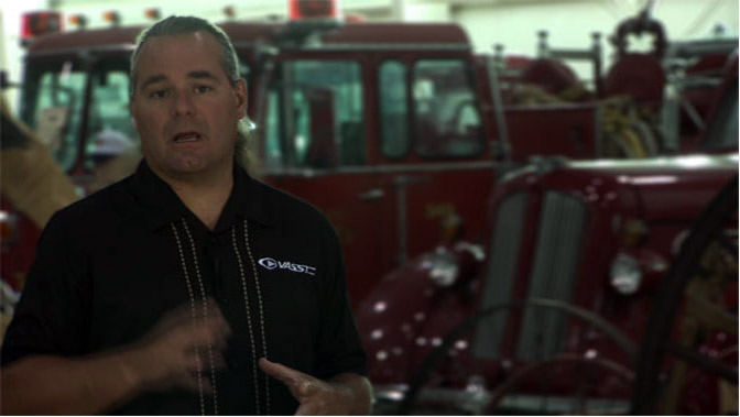

Attached is a shallow depth of field from the V1U. If memory serves, I'm about 8' from camera, iris likely at 1.8, 2.0, or 2.4, shutter definitely at 1/48. There may or may not be an ND filter on due to the light hitting the sides of the barn. I honestly can't remember, and don't want to go digging for the tape to read the datacode.
The "arm" you can see behind my right shoulder is about 4' back, and the nearest firetruck is about the same distance.
Screen cap from DVRack; a little underexposed. Apologies for that, we were juust prepping up for a shot and I hit "Grab."
