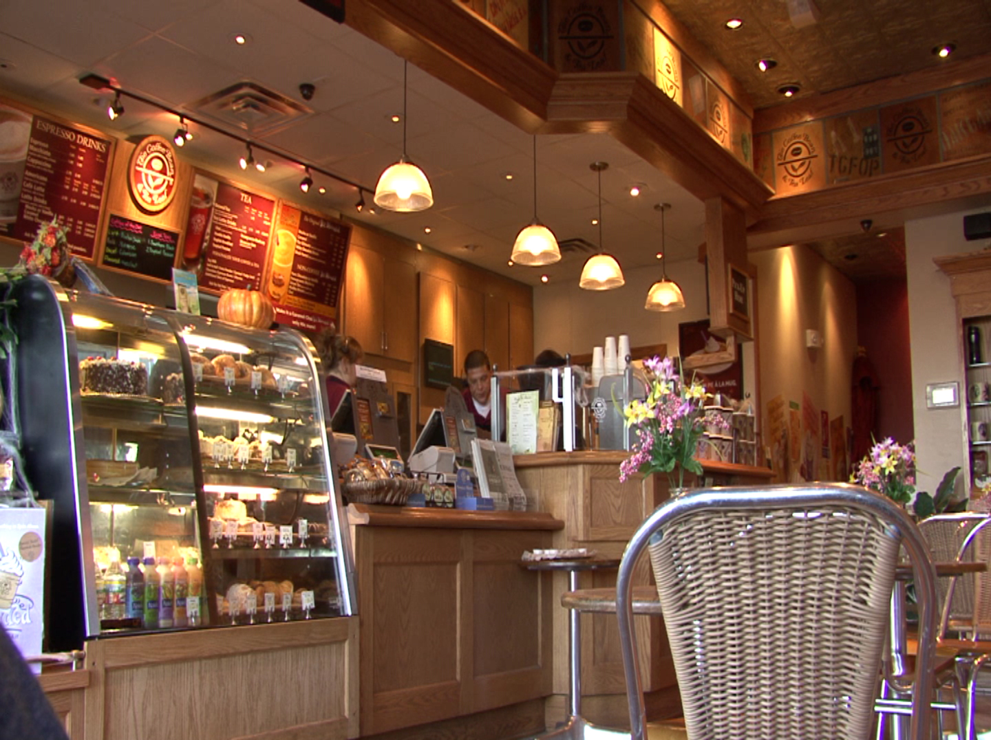

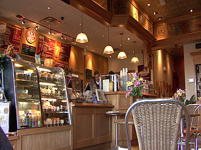

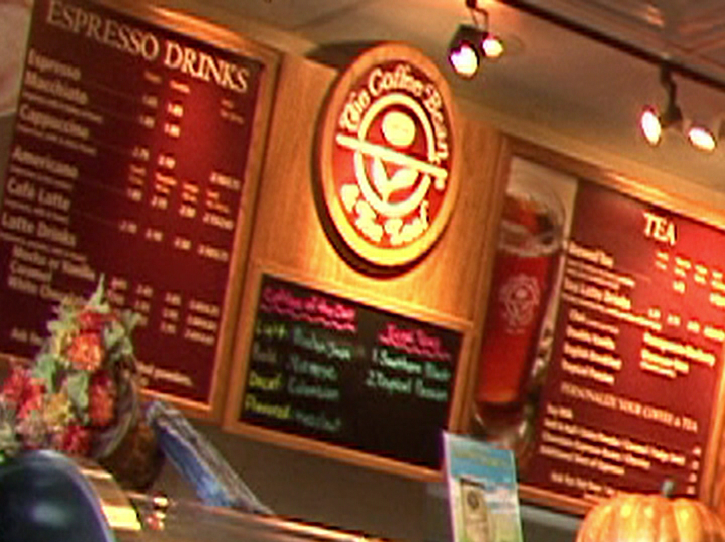

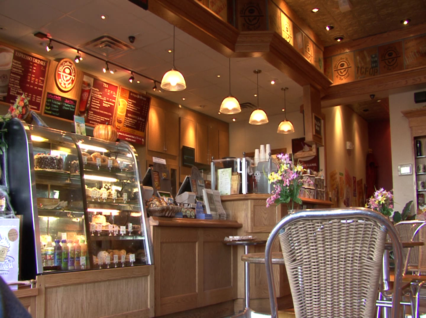

I captured a clip where I switched from 60i 360-degree shutter and 240 216-degree. So I had two side by side frames.
Used Liquid's super HQ 2D editor to blow-up these two frames by 400%.
No difference I can see!
If someone posts how to post them -- I'll do so. But I won't say which is which.

Here are four pix. We'll see if folks can tell which is which.
Obviously, these have all been JPEG compressed to meet site requirements so any attempt to judge original image quality is ruled-out. The point is simple -- can you see a rez difference.

I can't see one... I'm viewing on a laptop, but even so, no visible difference to me...

..I would guess the photo on the right has a ever so slight higher rez, & this a subjective viewpoint , on a 17" 1280x1024 LCD monitor....

#1 is interlaced
#2 is progressive
Did I get that right?

60i 360 vs 24p 216 400-percent 1.jpg looks like 60i?
