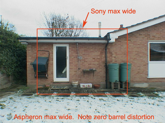

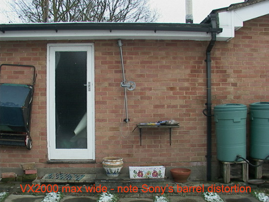

That's me Carlos. I've used and owned wide-angle converters made by Century, Raynox, Cavision, Tecpro, Kenko, Bolex, Red Eye, Canon, Schneider, Sony and probably some others that I've forgotten about.
Most were ok, some were good but only one is excellent - and that's the single element aspheric made by Bolex for their 16 mm prime Switar lens. It's not cheap, it's hard to find, it needs a special 85 mm to your filter thread size adapter making up and it's not full zoom through. But it is the best I've used.
Look here to see what a 0.5x rectilinear converter can do for you.
tom.

By not cheap, can you say how much? Who's selling it?
Yes, I had seen that comparison of yours before, and it's very revealing. Barrel distortion is a concern for me too, because it shows when you move your camera in any way.
In my case I should get a Z1 very soon, and the original zoom seems to have that BD distortion too. There's a Century .6x WA that I bought too, but that may take longer to get here (Brazil). Will report about it when it does.
The aspheric's test seems to show some chromatic aberrations, like on the vertical lines. Is that so or am I imagining so?

TOm, that looks unbelieveably fantastic! Where in Europe can the Bolex Switar be found?

Lol, yeah that's true!! But they're not really designed to be bought - most DPs will simply rent them when required...
That Switar W/A converter is dead sweet Tom, great info - can you give extra info to make sure anyone buying one gets the right thing? It's marked "Bolex 0.5x", I presume? Any other distinguishing markings?
I virtually never shoot without the M2/Nikkor kit these days, but I might be tempted by one of those for doco/run'n'gun stuff if I can find one kicking about...
Great find!

Well, that might be the case for full-budget producers. I was thinking of something indies could use.
I think I saw something aspheric going around the web sometime, but it was Schneider, if I am not wrong. On above, the mark on the lens should be Switar, never Bolex.
