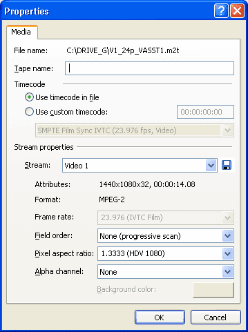

1. The clips posted on the VASST site are 24p.
2. The workflow in Vegas is simply to capture, and set the project for 24p HDV to remove. Vegas auto-sniffs the properties of the file.
The attached image is from one of the files downloaded just a moment ago from the VASST site, no different than any other file anyone might upload.
In this particular case, thefile is on a 60i timeline; notice that Vegas auto-sniffed, and has kept the 23.976 properties of the media intact.
You don't need to render uncompressed. If you're going to do that, you might as well render to a 4:2:2 format that FCP understands, with very lite compression such as a Bitjazz or BMD codec.

i stand corrected! i had forgotten about those clips. i'm curious to know what was the shutter speed... it looks like it's around 1/500th. there's no discernable motion blur. anyway thanks for putting those up!
now those clips are native 24p hdv not 24p-in-60i hdv, right? i load yours in vegas and vegas tells me it's 23.97p. i load everyone elses in vegas and it says 29.97i, and i see that there's pulldown. does vegas only removes pulldown during capture? and is there a way to force it to do that? thanks again!

If Vegas sees the 24p flags, it simply captures the data as such. it auto-removes the pulldown, and will do so with either the 24p or 24p "A" mode. I'm trying to be careful to not suggest it's 24"PA" mode so as to confuse folks that might liken it to Panasonic's 24PA mode.
The cam that was used for those particular shots was a pre-production model. I've got some 30p I'll post as well, now that we've cleared the footage.
Anyway, those clips were shot 24p, and yes, they're in a 60i stream, but Vegas doesn't see them that way in version 7c. It simply displays them as you shot them. No need to force, 7c correctly sees it. Shoot in 60i, and it will see them as 60i fps.
Shutter speed is fairly high, I'd have to put the tape back in to see the datacode.
