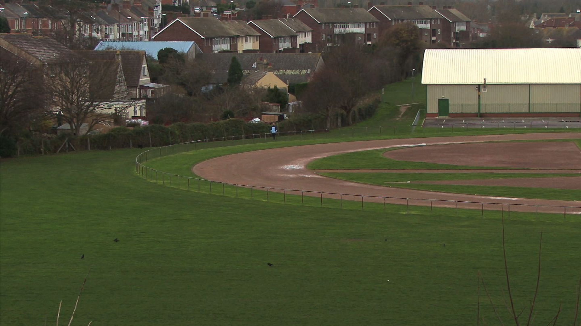

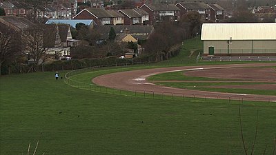

There was a lot of stairstepping in the original 25P footage before fix. A strange mix of over softening and aliased edges.
Look at the fence round the running track, perfect on the 50i frame but aliased on the 25P un-fixed frame.
I am wondering if these artefacts remain in "fixed" 25P and could be a result of NLE implementation as the 25P was captured as 50i.
Steve, can you shed some light on things?
TT
