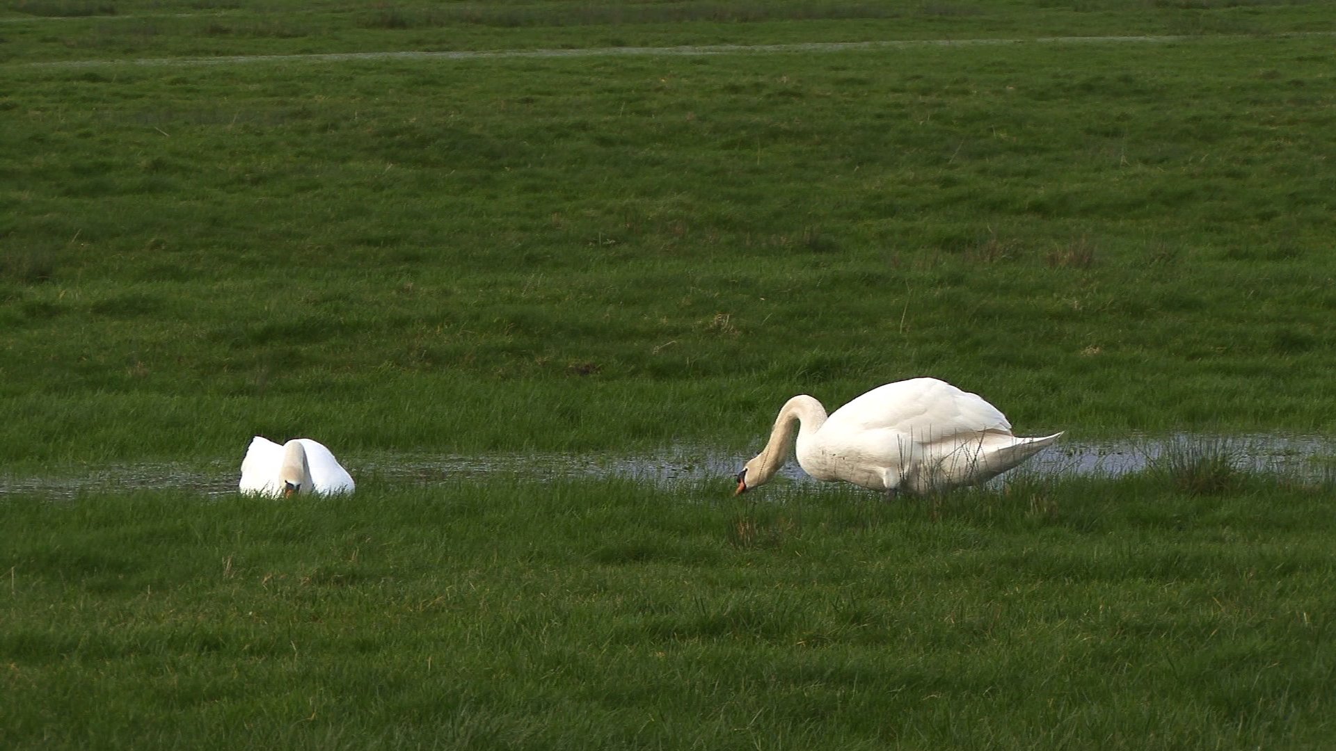

Stairstepping!!!!.
Originally Posted by Ken Ross
Glad to hear all is well now Tony!
Cheers Ken!
Might have spoken too soon!
For those that are interested check out the grab. Take a close look at the right hand swan and the stalks of grass in front of it. There is some stairstepping of those blades of grass.
The camera was left with the default sharpness of 7 (see the halo round the Swan this is why I prefer much lower. you really only notice the steps when close to the screen but from a viewing distance the image looks "very HD." Unbelievably sharp, almost too sharp for my eyes!
Unfortunately I don't have any more progressive footage shot with a lower sharpness setting.
I did a quick export to 1280x720P and the stair steps are no longer visible.
Question for those that know more about the HDV format than me,
Is this a limitation of the format that is showing up in this grab? perhaps the dreaded 4:2:0. But why are these jaggies not seen in 50i?
Am I worrying too much? At a normal viewing distance the jaggies are not visible and the image looks crisply sharp.
Anyone like to comment?
TT
If a TV made an utter hash of de-interlacing 25Psf (25P in 50i) then I could see these jaggies being quite visible.

Old January 4th, 2007, 11:40 AM   #11
Location: Kuching, Malaysia
Posts: 104
Hi Tony, it is nice to see you got everything just as expected, this image does look good apart from the strange "interlacing effect" spotted by you (oh my god, you really look into so much detail), I wonder it is because the glass is too thin and waving in front of white subject, will this make too much challenge for HDV encoding ?
Or is it caused by the rolling shutter recently mentioned by other thread ? I trust you didn't go with high speed shutter.
Or perhaps the high sharpness setting has splited the thin glass into pieces (so avoid default sharpness setting).
Or the 45 degree CMOS has done anything to this ?
I am sure you can do more test in coming days. But this oil-free image does put Sony back to the track :D.

Old January 4th, 2007, 11:53 AM   #12
Location: Paris, France
Posts: 75
Strange, Tony. There seems to be a lack of details in the overall image, but that's probably because I just checked out some Red frames... These "steps" you're talking about look a little bit "interlaced", but that's probably me. Have you checked the way you capture ? Do US users have this problem with 24P ?
Thanks for this frame grab, looking forward to discovering 25P footage !

Old January 4th, 2007, 12:41 PM   #13
Location: New York
Posts: 1,945
Tony, how obvious is the stairstepping on moving video? I don't trust frame grabs as they tend to introduce many artifacts not visible in the moving video.
I agree with you about the default "7" sharpness. It is exceedingly sharp, but can introduce those halos around certain objects. Many times, depending upon the scene, you won't see it at all, but at other times it's there. But I have to admit I love that super-sharp look....it's kind of what HD is all about. I may try a setting of '5' and see how that looks, but I seem to recall that I could still see some halos around wires against a sky when I was experimenting with my FX7 @ a setting of 5.

Old January 4th, 2007, 01:06 PM   #14
Posts: 1,414
Hey Tony, I could be wrong here and only one way to see for sure but
the grass that you describe could actually be the seed stalks for that
particular grass type... the blade that runs across the neck for sure looks
at first to be stair'd but again, to me it looks like a seed stalk...
You'd have to go out into the marsh and look at the grass, but it is that time
of year for grass to seed ... :-)
If indeed those are seed stalks then I'd say your cam is doing a fantastic job of detail.. :-)
The seed stalk I'm talking about is not a grass blade, but a long straw that
comes out around the grass into the air and it has the seeds on the stalk.
Ray Bell is offline
Old January 4th, 2007, 02:50 PM   #15
Location: United Kingdom
Posts: 451
Unfortunately it isn't seeds. I have a close up and they are just blades of grass.
I wonder if 24P users notice any artefacts like this?
50i looks much better in my opinion. All the fine detail has lovely anti-aliased edges in 50i.
Anyone got any ideas?
