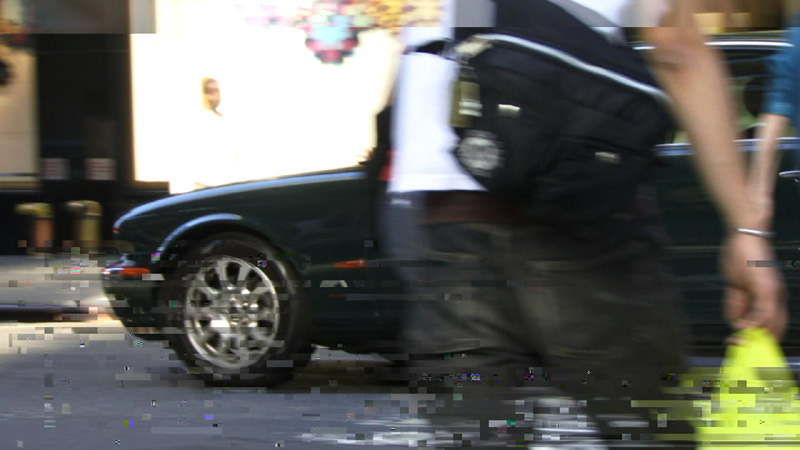

Old June 1st, 2007, 08:23 AM   #24
Posts: 1,435
Is that what your dropouts look like? - see video cap from V1U attached.
I got 2 of those on the first Sony HDV tape used on a brand new V1U.
Did not clean the heads beforehand.
The dropouts seem to be mild comparing to Z1U's, which lasted for about a second - V1U's were only 1 frame long.
