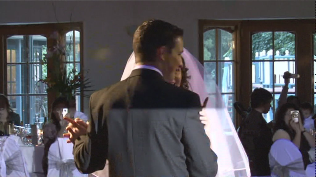

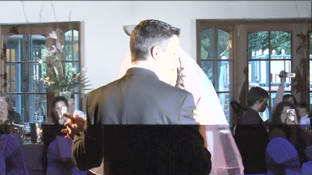

Has anyone else noticed the weird effect that the rolling shutter produces on photographers flashes.
I have been using my FX 7 at weddings for almost 3 months now, and was noticing that each flash seemed to produce 2 flashes in the viewfinder instead of one! Very Disconcerting!
It is the rolling shutter doing this of course, and seems to be a permanent "benefit" of this technology.
I have attached stills of two adjacent fields to show you what I mean.
When at the wedding or reception it doesn't matter much, as you can put it down to a pre-flash, or even two cameras, but when you at the bride's house and there is only one photographer in the room, it is annoying that you see two flashes virtually every time the photographer takes a picture.
I'm sure it will only be a matter of time before a bride picks it up.
Anyone else noticed this?
Cheers Vaughan

Here's a very small clip of slo mo to show you what I mean.
One flash shows as two distinct flashes (50% slo mo)!

That's what I was calling a "pre-flash".
No, it's a professional photographer in the bride's room with a pro DSLR and only one flash.
I've seen it in every wedding I do, and at first thought it was a camera fault, until I slowed the footage down and realised it was the caused by the rolling shutter.
It's alright unless you slow the footage down in editing, ....as you do for a wedding video.
The next flash that went off in the room was effected even worse than the first one.!!!! (This is the last sample, I promise)

Seen it with single CMOS
Hi Vaughn -
I noticed this same effect the other night while editing some footage shot with a Sony HC1 - single CMOS... strange that this phenomenon hasn't gotten more attention...
It's very odd seeing a flash that happens in s fraction of a second bounce from the top half of the frame to the bottom half of the frame... I had to look at it a few times to convice myself I wasn't halucinating... that and I noticed on frame by frame scrolling that when a flash goes off, it often "frags" parts of the subsequent frames - patches of pixels almost as though it overloads the compression algorithm - looks blotchy, like an overcompressed .jpeg...
This video was shot in an afternoon wedding, adequate but not great light. The only way I noticed it was on a 24" computer monitor, full size... I'm guessing that it might become less of an issue once I render it.
Probably wouldn't be an issue MOST of the time, but it sure presents an issue when shooting a wedding... and flashes are going off every which way! Another reason to ask for no/limited flash photography!
This rolling shutter thing is apparently a CMOS issue, and it sure presents a few challenges when shooting - got to really keep the cam stable while shooting - anyone know if the Canon HV10 single CMOS has this same peculiar problem?

I wonder if it will be possible to eliminate the rolling shutter issue (which is what this actually is now that I've seen it and understand it a bit better) by addressing the chip differently? Like all things electronic, it should be a matter of speed and or programming... all in due time, meanwhile pick the tool that gets the job done, I guess!

I have heard that rolling shutter is worse/mpore noticeable at high shutter speeds. So, perhaps, in these situations, try slowing shutter speed down to 1/25th (when there's lots of flash photography going on) and see if that helps reduce the effect. You could do some simple tests to see if changing shutter speed helps at all.

On some of the flashes that were affected severely in slow motion, I have put a quick "flash' over the top, to make it look like the original flash.
A Vitascene flash transition seemed to have the best effect and it looks much more natural.
I am convinced wedding editors should be made aware of this limitation of the rolling shutter camera, as I have decided to limit this camera to 'deck' and non wedding use and and probably go to the heavier Z1 for my weddings.
