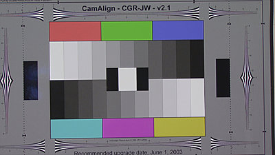

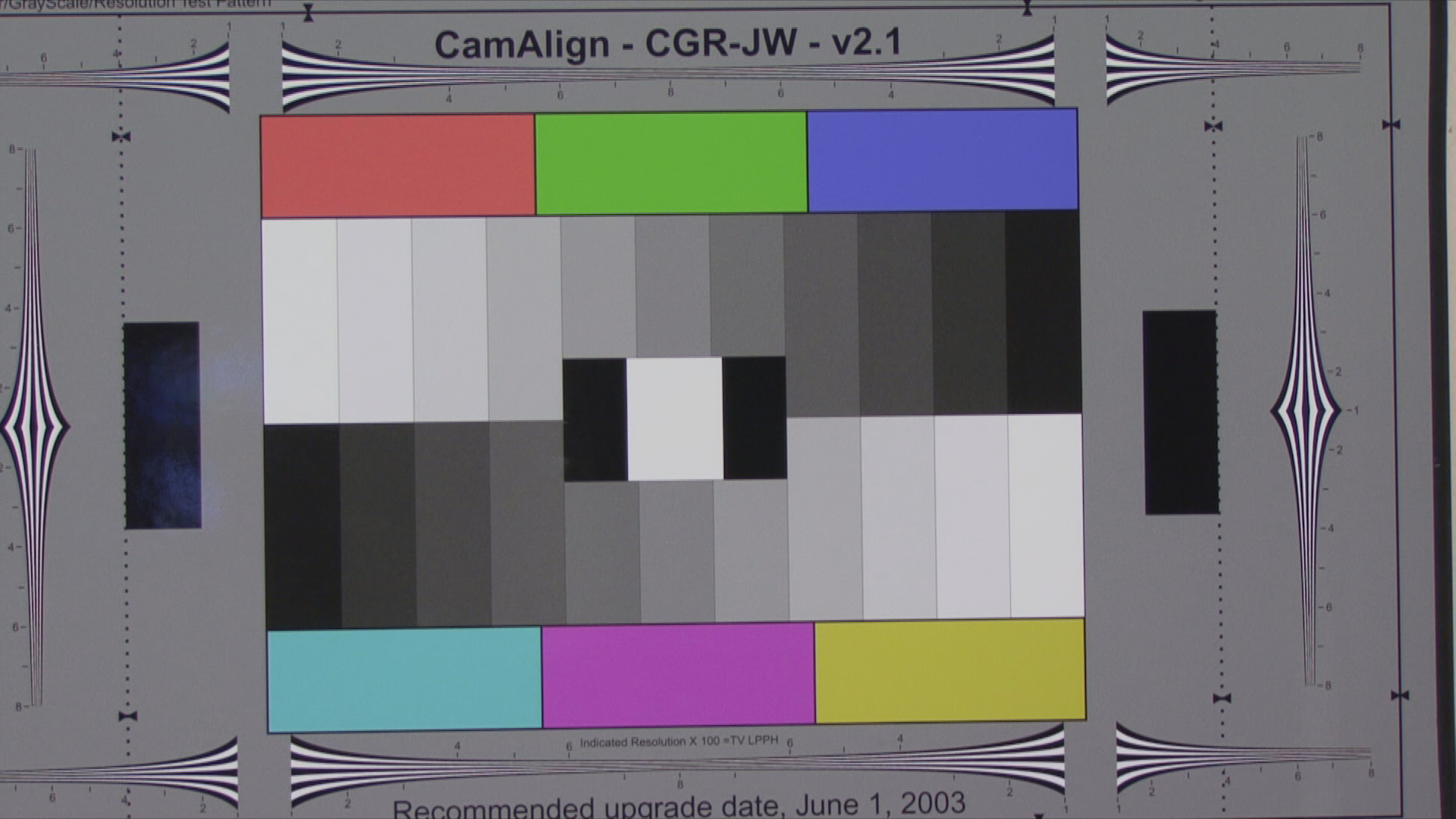

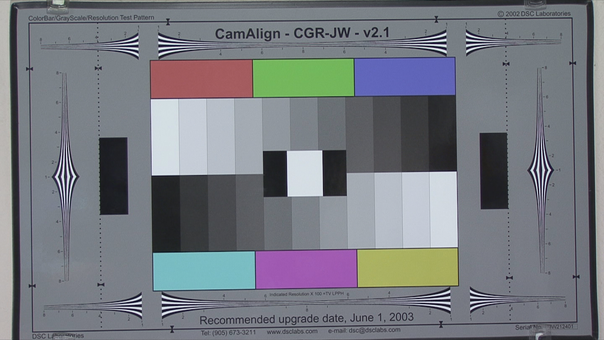

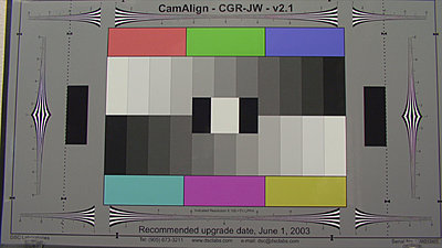

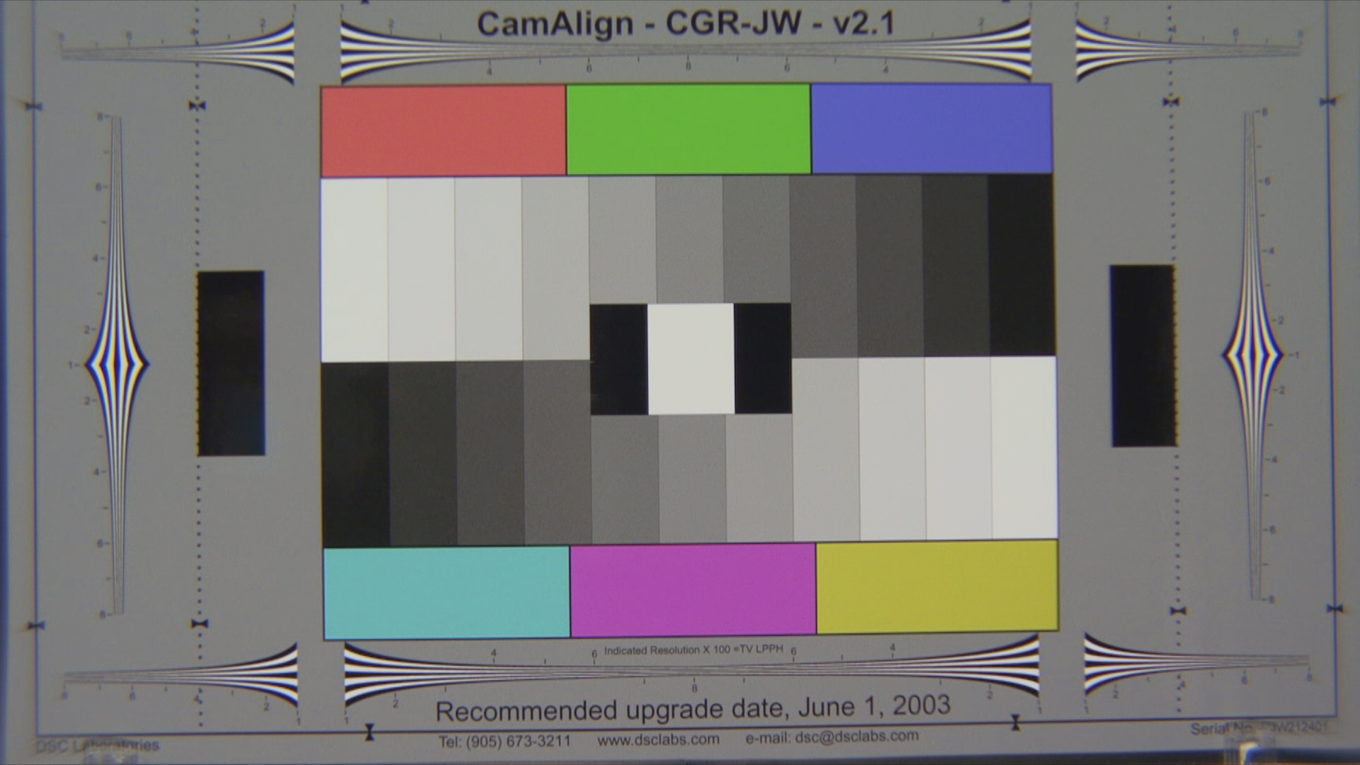

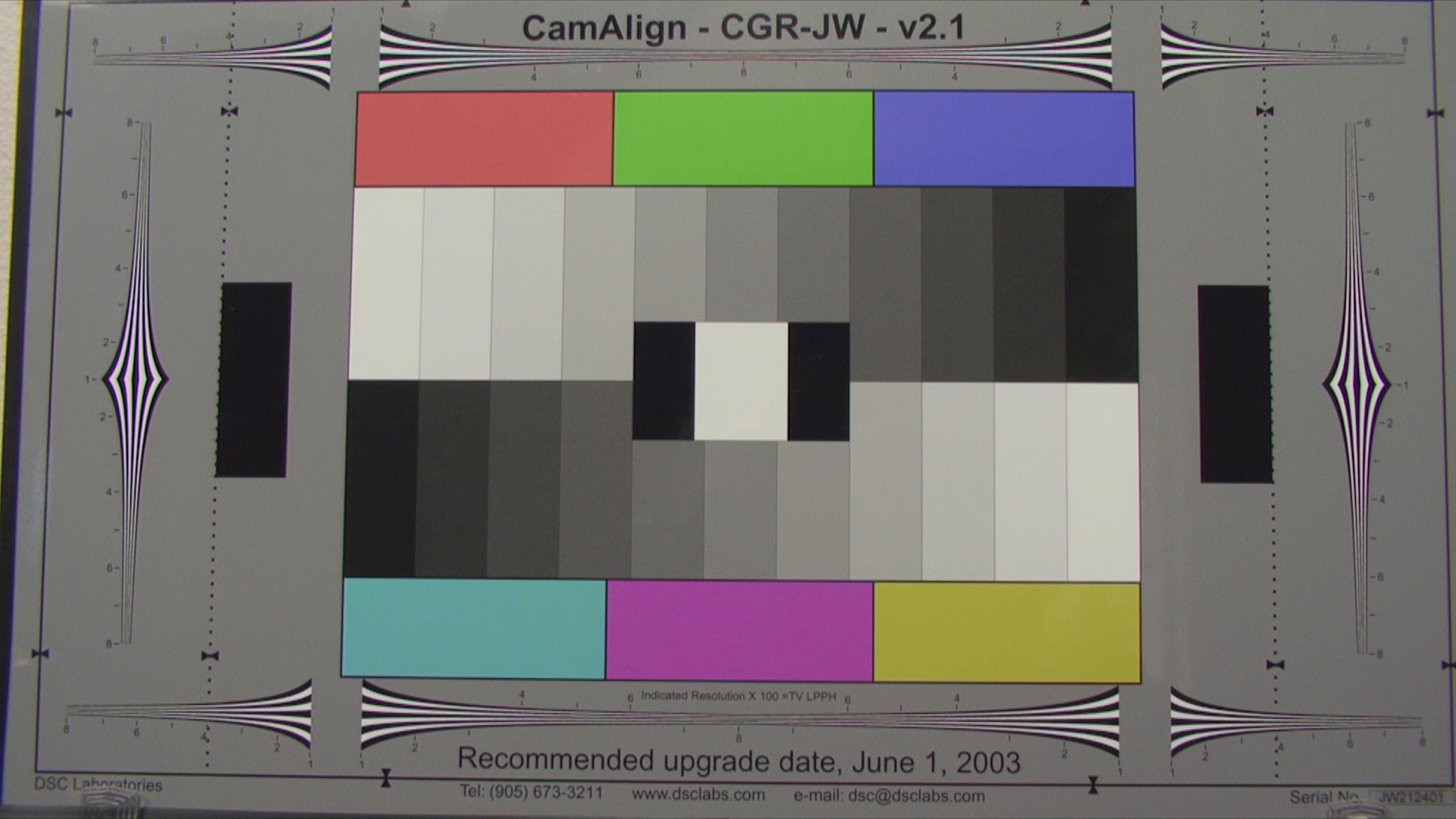

Charts for Raynox 7062
Well, my engineer buddy did not have a full rez chart stuck on his wall, but this combo chart.
Interpret as you will, here are several caps at native resolution. I'm interested to know what more experienced eyes make of them, as I flew in and out of my friend's shop (got a little overextended today...)
Note that most of these were at Zoom 66, one at Zoom 25 (100 = full tele).
***edit***
Note that the WA zoom 25 file's distortion was produced because we couldn't get the darn camera close enough to fill the frame. Had to go off the bench on a pile of apple boxes, and the height wasn't quite right, so the perspective is slightly off.

And Raynox has done more than most manufacturers to try and combat barrel distortion in their converter lenses. The 6600PRO is a prime example of this, but in controlling the distortion there seems to be a price to pay - loss of image quality at the telephoto end.
But you've bought a wideangle converter to give you more wide angle, and you certainly shouldn't shoot at 15mm (say) with the converter lens in place when your normal zoom will do a much better job at that focal length.
