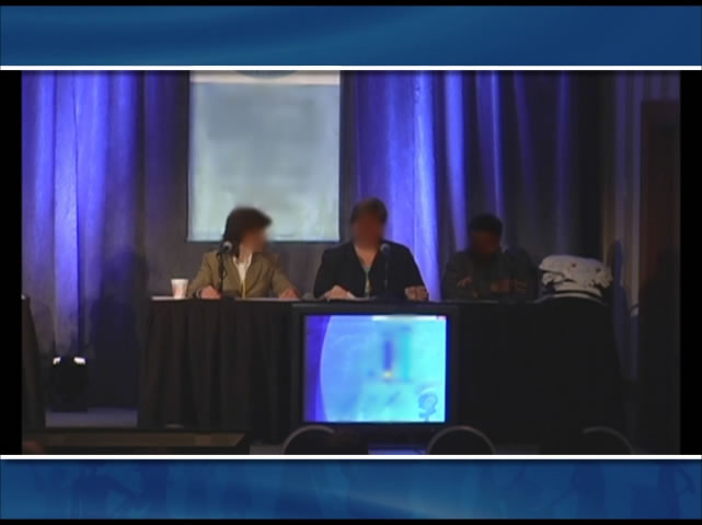

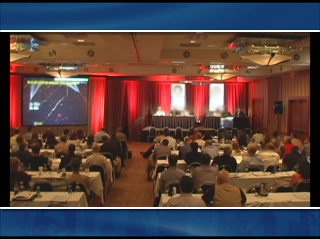

But, as an fyi, here are some non color corrected shots of the typical events I would be shooting with the actual light conditions. On second thought, after seeing the images, the house lights are probably dimmed only 50% instead of 75%.
This footage was shot with the Panny DVX100b (10x optical) at the back of the ballroom about 75 feet away.
http://www.ibiblio.org/nmitch1/dv/image_1.jpg
http://www.ibiblio.org/nmitch1/dv/image_2.jpg
http://www.ibiblio.org/nmitch1/dv/image_3.jpg
http://www.ibiblio.org/nmitch1/dv/image_4.jpg
Thoughts now about how the V1 may fair in this kind of moderately lit environment?

The only picture that worries me a bit is the mid shot of the stage.....the others should be O.K.
I see from your shots that the camera is at the back of the hall..a fair way back.
You will find the dark areas will appear a bit darker with the V1, but the lit areas should be the same. I find that the camera reproduces about what the eye can see, but even when it is struggling at + 18, it is quite a clean picture so you can easily lift the dark areas in post without seeing a lot of grain.

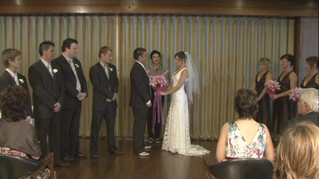

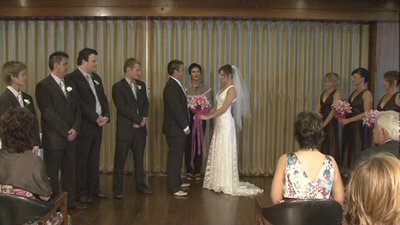

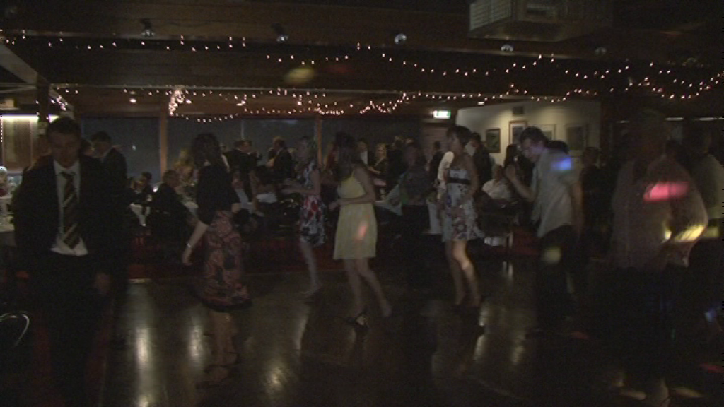

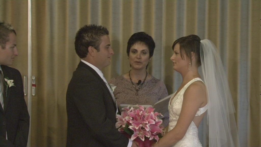

Later: I've now uploaded 4 images for you to look at. (wrong order - sorry)
No 00003 - wide shot, wedding in dark room, there were several spots, but they were directed down at the seats, so the B & G were actually in the shadows.
Camera was +18 (PAL - so 50i)
No 00004 - zoomed in on same
No 00001 Shot of room pre dinner drinks (about dusk), windows behind me
No 00000 Dancing at night, wide panning shot, no-one in my light at all.
Hope this helps Vaughan
