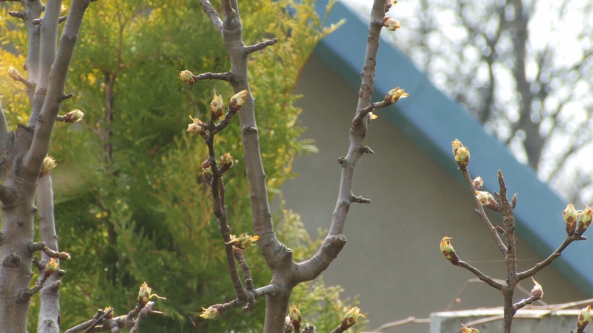

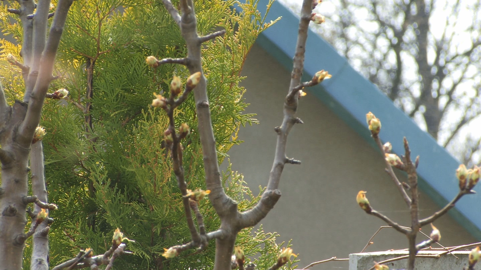

Here's a snapshot from a casual shot through the window with my V1E; you can see there is a couple of "planes" I could easily get into focus while blurring the others:

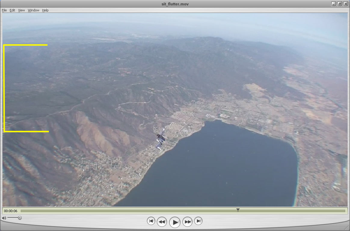

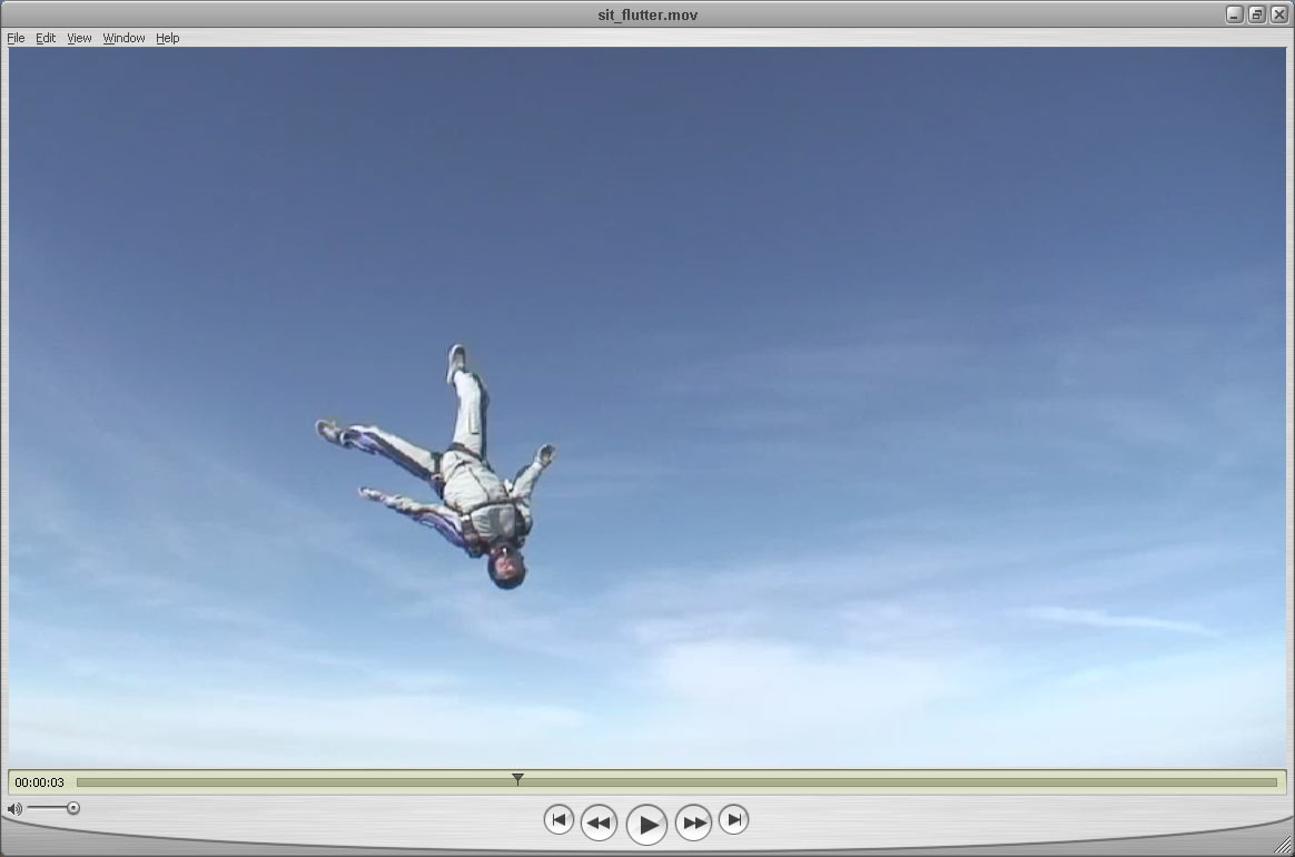

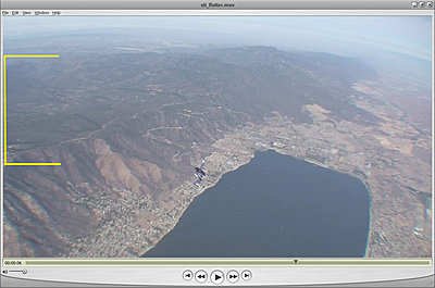

Rolling shutter can be seen at any speed over 1/60 in a variety of situations, particularly that where the camera is moving fast over a horizonal line or near horizontal line. In some very rare instances, rolling shutter can be seen even at 1/60.
Image One shows the subject with nothing of substance in the background.
Image Two shows a semi-horizontal skyline, same subject, less than 3 seconds later. Rolling shutter is *very* apparent in the video, and visible in the still frame grab I just captured using PRT SC.
Additionally, high shutter speeds are of course, very common in many forms of video production, such as when slow motion is the end goal, to name but one of several reasons one would use high shutter speeds.
Questions about V1U-norollingshutter.jpg   Questions about V1U-rollingshutter.jpg
There's nothing seriously wrong with the area marked by yellow.
Moreover, no one in an audience is going to be looking at the upper corner of such dramatic footage. Eyes automatically focus on the falling person.
You are confusing what you see in post with what an audience sees. By your logic, filmmakers would not use any footage that had background strobbing. But, they do use such footage because they understand that while THEY see it, the audience will NOT because the camera person tracked the Subject.
Thus, the issue is not does a camera record an artifact, but is it relevant to story telling process. Which is why I said if you aim the camera at a fan you will see it. The fan has become the SUBJECT.
Keeping shutter-speed between 1/30th and 1/120th assures motion will be rendred naturally. Anything slower and not only is motion unnatural -- the increased blur cuts detail resolution. Anything faster than 1/120th and there is not enough motion blur to connect frames into a smooth series.
As a I said, you are free to break these rules if you are creating an FX like the SPR look. Slo-mo is another FX.

Okay, rolling shutter is 'very apparent'. Well its not very apparent to me? What am I suppose to see?? The only thing I see is the horizon line is not straight (and that is out of the yellow band area that is marked). That could be the result of using a wide angle lens with some distortion. Is that the effect of the rolling shutter here? The horizon line is arced slightly, just like any wide angle lens over 24mm or less on a 35 SLR? I assume this was with just the normal lens - no wide adapter lens? If so, yes it is distorted, but I agree, its not bad enough, that in a moving video, you would say "oh my gosh look at the distortion from the rolling shutter. If I am not looking or 'seeing' the right things here - please explain what I should be looking for. No disrespect ment, and as always, on small snap shots downloaded over the internet - it is not always easy to see what was clearly obvious to the one looking at the original footage. Thanks - PK
