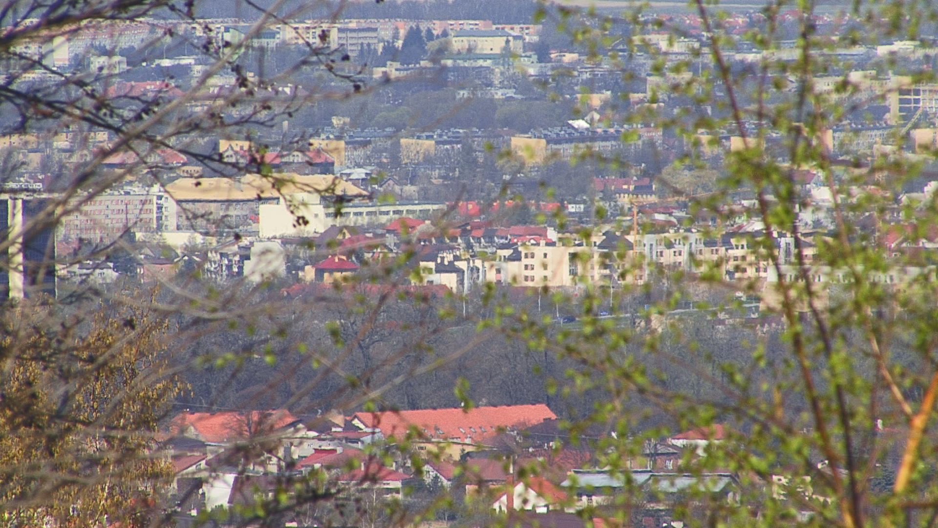

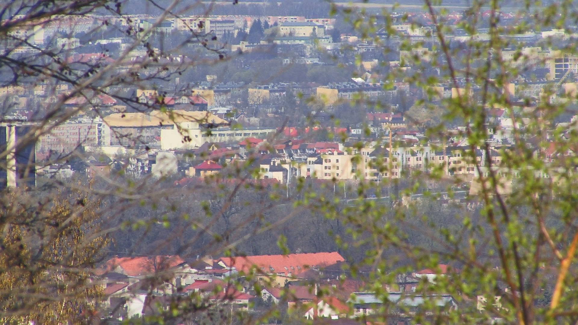

I almost came to terms with this, and thought I found the right way of using the progressive mode on my V1E so that the artefacts are minimized - until recently, when I discovered the oil paint effect is actually still there. Or, to be more precise, the potential for it. I shot some video at full telephoto, in both 50i and 25p (sharpness the same at 7). Attached are snapshots from both; you can compare detail in the dark green trees in the distance.

important update
I've just got a satellite receiver with a couple of HD channels, including Discovery HD. Watching them through component on the very same full HD devices that I've used in testing the V1E, I'm actually astonished how good my own V1E footage, including the 25PsF mode, really looks compared to some stuff broadcasted by Discovery HD!
Areas of lower resolution (the dreadful oil pain effect)? It's there too, mainly in the one-colour areas like green trees or grass!
Line twittering? Plenty, like on the brick edges!
Aliasing in contrasty edges, like white letters on black background? Very often!
Noise in low-light? Of course - in many under-water or night shootings!
Considering the quality standards adopted by Discovery HD, and the highest-end cameras used for production, the V1E is not bad at all in this comparison.
Another friend sent me some video shot with a V1P. The shooter had not yet read my book and so shot 25p at 7. But they loved the footage!
When I watched it I was blown away. It looked more detailed than my U video and yet had ZERO twitter! And, no aliasing on hard edges. NONE.
About the same time you posted your pix showing P looked softer than I.
At the same time, Adam Wilt wrote that in I mode the U was soft. He called it "looking through ground glass." In my review I called it "filmic." Yet when he switched to P he said the ground glass was removed -- the picture become clearer.
What's going on? I'll let folks ponder this while I write down my thoughts.
