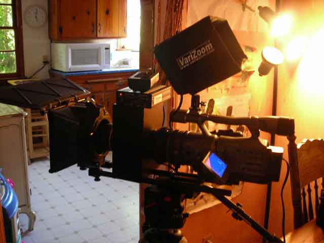

FX7 new rig here
Just building this:
Home made 35mm DOF box.
Uses pretty much home-found parts except for a 72mm Redrock HD achromat which I've got on a 62/72mm step-up ring at the moment.
(planning in using this box with other cameras with larger lenses as well, otherwise I might well have gone with 52mm)
Uses a standard Cavision 15mm rod system.
That's my Chroszeil 4x4 matte box off my 16mm camera up front.
Beachtek 8 and Varizoom monitor battery sitting on top of the DOFbox until I find a better home for them.
Nikon primes for the moment. Maybe 35mm movie primes later on, we'll see how this goes.
The Varizoom 7" monitor up top does the unflipping and reversing.
Love this camera!
