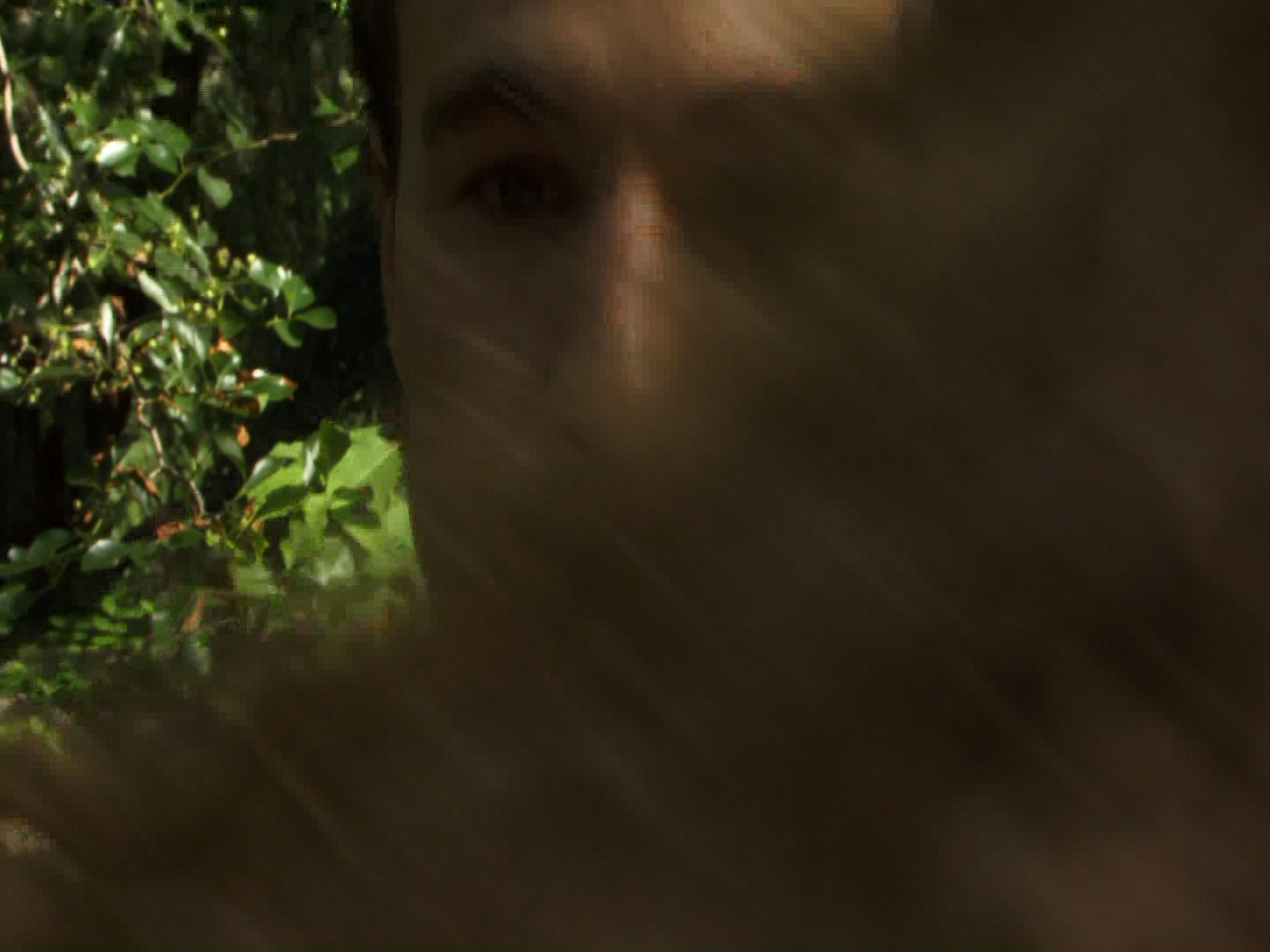

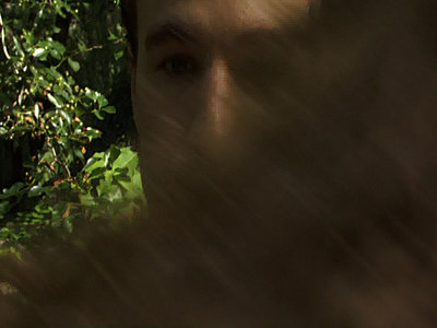

OK, here: this was shot with V1U last week in Central Park NYC, recorded on tape (HDMI *not* used).
The setup: girl's head is between the camera and the guy.
Girl moves to the right and out of the frame, fast.
See the trail of macroblocks on her hair and to the left.
Guy's face in the background is also affected (and will be for a couple of frames even after the girl is completely out of the view.)
Tree on the left is far enough from the action and is unaffected.
I captured that frame from the NLE as bmp, and then saved as jpg to decrease file size. This did not change how the still cap looks.
So there you go.

Yeah, this definitely is ugly. Does it last long enough to actually see it when playing at normal speed?
Again, I've never spotted anything like this on my recordings. When I find a single frame that looks as bad, I'll let you know!

You can hardly ever notice it at normal speed.
In my case, it lasted for a few frames altogether.
That's why people think the blockiness is not there.
FYI, this was shot at 24p, but it does not matter - the same thing occurs at 30p and 60i. Z1U did the same thing too.
Once again, V1U cam is actually great: simply capture from HDMI out live (i recommend Cineform Aspect HD as codec of choice), and voila - no macroblocks on fast motion.
