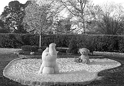

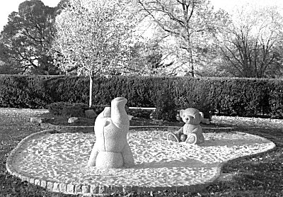

Kevin,
I was on my way out and didn't mean to sound terse in the other post. When shooting in black and white one has the advantage of carefully manipulating the lighting by using either artificial light sources or camera filters. If you were to shoot in black and white you would have the ability of monitoring the effect you are attempting to achieve. That way you can add or remove filters based on what the project calls for. An example would be using a yellow filter (see attached photos, the one on the left is with no filter). There are a few more examples here.
Some editing systems have the capability of manipulating images far more than what camera filters can achieve. If you know that you can make all these changes in post, then shooting in either color or B&W will not make a difference.
