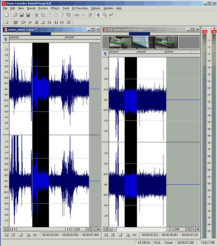

Piotr,
Here is your audio taken into Sound Forge alongside my own "V1E Zoom noise test.mov" file I uploaded earlier. I had to convert your mpa to wav to be accepted and I also had to increase amplitude to see both more easily.
The black shaded areas are where I made selections and on yours (at left) this is where I hear the zoom motor, I think this does corrospond to your video.
Mine is at the right and the selected area is where I can tell from the little video preview along the top that plays that I am zooming, there is no change in the audio that I can hear or indeed observe from the waveform unlike yours where the waveform suddenly drops as you complete the zoom. Interestingly I can even hear your zoom motor beneath the louder background noise burst where your zoom starts.
Informative?

While I'm very grateful to Claire for the time and effort, I'd appreciate a comment from somebody, who - like me, unlike Claire - is using a mic hotter than the stock V1 mic, but in the V1's own mic holder. This might make a lot of difference. TIA!
