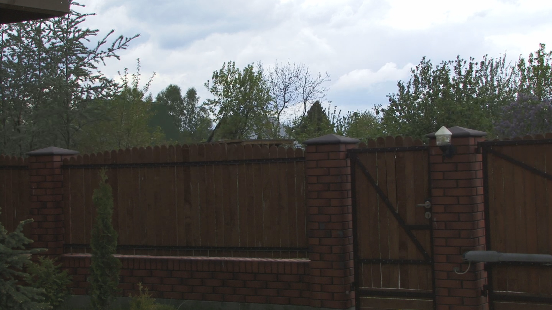

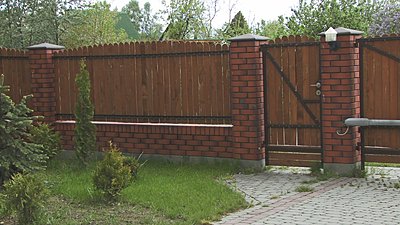

sky overexposing: will French flag help?
This is a naive question, so please forgive me. I never was so serious about getting as good video as possible before; the V1 is my first camera I'm considering fixing a French flag to. Not a full matte box (I guess it would be an overkill for my purposes), but something that would help handle light better. Frankly, I'm not even certain it's a French flag that I need, so let me explain.
With fine weather, plenty of sunshine, I have no problems with properly exposing my video. However, when the sky is overcast with light-gray clouds (not those dark, stormy ones), I get them overexposed long before other areas get proper lighting! When I open the iris to properly expose anything else, those clouds are gone and the whole sky detail is blown away. Please take a look at those grabs that roughly illustrate the situation.
Now, my question is: will a french flag help in situations like this, when there is high contrast with the sky above? If not a French flag, what can help?
I know this is a very general question on filming techniques; if I put it in the V1 forum is because I'm seeking advise with this particular camera in mind. Unfortunately, setting knee low and stretching blacks is not enough with scenery like this; I've even been wondering why the knee lacks a really low position, that would allow for 1-2 full stops more in bright areas...
sky overexposing: will French flag help?-image5.jpg   sky overexposing: will French flag help?-image4.jpg

no it will not help.
you need a progressive ND filter (dark at top, transparent at bottom).
This is elementary accessory used by photographs , most of time ignored by videographs.

Piotr, you are running into the biggest problem with electronic cameras. The exposure latitude is much less than the human eye. In big-budget movies, a whole lot of lighting gear is used (and a lot of money spent) fighting difficult lighting situations.
Of your two examples, the best exposure is the first one where you kept the exposure a bit low. It may not look like that, but if you assume color correction is going to be done in post you want to ensure that the whole scene is within exposure limits. A little underexposure to prevent the sky from blowing out is good because there is still enough detail in your highs, mids, and lows to create a good final result. If you overexpose and the sky disappears, the only thing you could do in post is use a luminance key and put in an artificial sky. In some circumstances, this may be preferable. The good thing about the V1 is that it doesn't smear out other details when part of the scene overexposes, so at least only the sky is ruined.

Markus, if the left (underexposed) picture is the right one - what kind of tool do I use in post to lighten the fence, while keeping detail in the sky?
