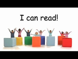

For a children's video I did last winter we constructed a large white cyc out of seamless paper and used the waveform monitor to make sure it had even lighting, and deliberately overexposed it to pure white. Then we lit the subjects separately, about 20'-25' off the cyc. All in all probably 15-20K watts of light used for the setup.
