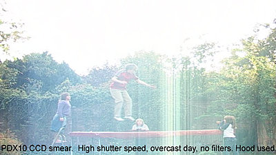

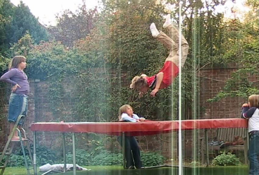

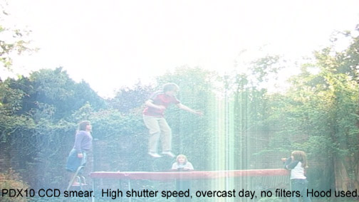

Most CCD cams are far more prone to CCD smear at high shutter speeds. Your 'graininess' description doesn't sound like this though.

CCD smear was a disastrous failing of the PDX10. I tested the camera for Computer Video magazine a few years back, and my tests showed that smear made any shutter speed faster than 1/100th sec a no-go area.
