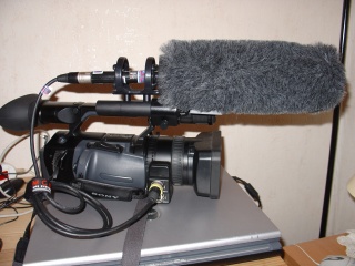

The price of the rode mount is 69 $
Rode SM5
http://davlombard.free.fr/forum/sm544e.jpg
Online Shop
http://www.fullcompass.com/Products/...070/index.html
On my Z1
http://davlombard.free.fr/forum/z1mic1.jpg
http://davlombard.free.fr/forum/z1mic2.jpg
http://davlombard.free.fr/forum/z1mic3.jpg
Z1 Full Res Pic
http://davlombard.free.fr/forum/Z1LDC.jpg
David LOMBARD

Gentlemen - you two have answered/solved all my issues. The Lightwave since I have no contacts to have the bracket built - it's off the list. Mounting the wireless on the battery picks up that feature - neat solution - still leaves the shoe for the light! So the Rode is the one I'll purchase - I was able to find everything but what I was looking for as a answer. Your responses totally made all the pieces fall into place!
