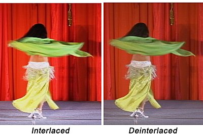

Perhaps an illustration. I've attached a frame capture from before and after deinterlacing. I use VirtualDub with the SmartDeinterlace filter. I'm not sure how the various cameras handle pauses on the LCD screen, but TVs are generally interlaced--I'd expect to see a more-or-less smooth picture when pausing FX1 while playing on TV, since most (affordable?) TVs are interlaced. Perhaps somebody more technical could offer a better explanation.
Anyhow, you will lose some picture information because you are joining two different fields that were taken at two distinct points in time. Each field contains only half a picture. Instead of taking 30 full-blown pictures per second, you're taking 60 pictures (fields) with half the picture missing--alternating halves are taken so two halves comprise 1 frame. Right, so you probably already know that. So, add the two fields together and you get a frame--but you gotta guess at how the two fields fit together correctly, since they *are* two different points in time. That's where you're losing resolution--you have to guess at how the two different points in time should be put together to represent 1 point in time (where the final 1 point in time is twice as long as either of the the original points alone).
The left image in the attached capture represents two fields of one frame being exported to a single image, with no interpolation, blending, bobbing, or weaving. The right image has been through VirtualDub (and Color Finesse, too...). You can see some blur if you look closely (or even not too closely--it's pretty high motion). Putting the two fields together means VirtualDub had to make up some information to try to get the two fields to look decent as one progressive frame.
Hope this doesn't provide additional confusion....

"So, add the two fields together and you get a frame--but you gotta guess at how the two fields fit together correctly, since they *are* two different points in time. That's where you're losing resolution--you have to guess at how the two different points in time should be put together to represent 1 point in time (where the final 1 point in time is twice as long as either of the the original points alone)."
Thanks Matt:) So somewhere in the confusion of figuring out which frame goes with which frame, some information is lost?
