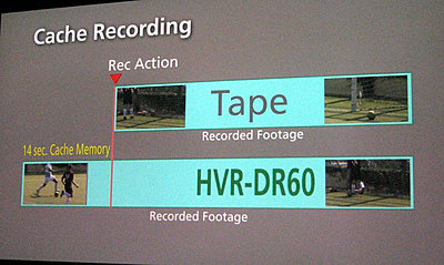

Sony's DR-60 would be a nice way to avoid those problems :-)
http://bssc.sel.sony.com/Broadcastan.../hvr_dr60.html
