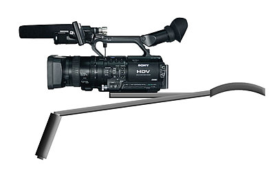

I've been mess'n with the concept of getting the center of gravity behind the hand grip.... so the cam won't be so front heavy like it is with the sony shoulder support..... any ideas?

I have. I shot an entire wedding with it the other day.
